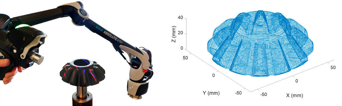

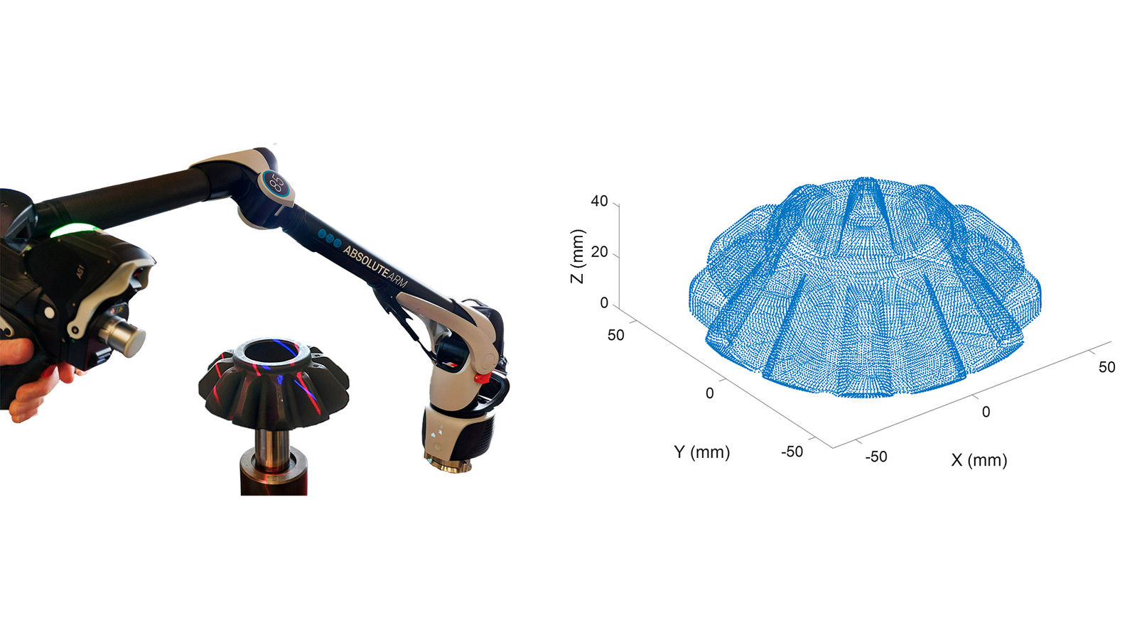

3D Scanning
The method described in this paper is specifically illustrated through the analysis of a planet gear from a commercial vehicle inter-wheel differential. It is assumed that the original geometrical parameters of this design are unavailable and required for further studies. The process begins with 3D scanning of both the sun and planet gears. The planet gear was scanned twice: first while supported on its back face as shown in Figure 1 (left) and then inverted upside down. Each scan generated approximately 30 million data points. These scans were subsequently merged and exported in STP format, resulting in a refined dataset containing over 40,000 points. The Cartesian coordinates of each node defining the 3D shape of the part were then extracted, as shown in Figure 1 (right).
Figure 1—3D scanning of planet gear (left) and point extract (right).

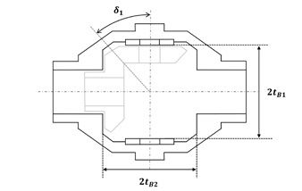

The mounting distances of the planet gears tB1 can be obtained from the differential housing by measuring the distance between the contact surfaces of two opposite planet gears using a caliper. If a friction washer is present between the planet gear’s back face and the differential nest, its thickness should be included when estimating the mounting distance, as illustrated in Figure 2.
Figure 2—Differential housing and mounting distances.

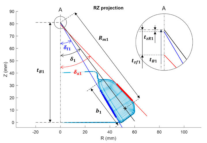

RZ Projection
Once the basic geometry has been established, the Cartesian coordinates obtained from 3D scanning are projected onto the RZ plane. The objective of this step is to determine the face angle (δa1) and root angle (δf1) along with the face apex beyond crossing point (tzF1) and root apex beyond crossing point (tzR1) of the scanned planet gear.
For that purpose, the highest and lowest points along the gear flank—defining the face and root cones, respectively—were identified and isolated. These sets of points should form straight, continuous lines. Any points associated with root reinforcement shapes, blank outer radius, or chamfers were visually identified and removed from their respective sets. In Figure 3, root points are highlighted in blue, while face points are marked in red. A linear equation was fitted through both sets of points. For the face points, an equation in the form
(2)
was obtained. From this equation, the face angle (δa1) and face apex beyond crossing point (tzF1) can be determined using Equations 3 and 4:
(3)
(4)
A negative value indicates that tzF1B1, as illustrated in Figure 3. A similar process is applied to the root points to estimate the root angle (δf1) and root apex beyond crossing point (tzR1).
Figure 3—RZ projection of planet gear points.
At this stage, the pitch angle δ1 previously defined can also be plotted on the RZ graph, given that the pitch line intersects the crossing point of RZ coordinates (0, tB1). The pinion face width (b1) was estimated as the absolute distance between the first and last point of the projected profile that intersects the pitch line.
Finally, a cone distance (Rm1) was arbitrarily defined by selecting a point along the pitch line and within the limits of the previously defined face width. This reference point will be used in the next steps to establish a transverse section of the gear. Within this section, the meshing of a straight bevel gear is considered equivalent to the meshing of a cylindrical spur gear with virtual geometric parameters. This transverse section will be used to estimate the tooth thickness, pressure angle and tool tip radius.

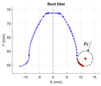

The edge radius of the hobbing tool (ra0) has been shown to be proportional to the minimum radius of curvature (ρf) in the generated root fillet (Ref. 3). This minimum radius occurs at the beginning of the trochoid, at a point where the profile is tangent to the root diameter. At this point, the relationship between these parameters is expressed as follows:
(19)
Since the pitch diameter (de1) and dedendum coefficient of equivalent spur gear (h’f1) were determined in the section “Profile Shift, Addendum and Dedendum Calculation,” the only unknown in this equation required to determine ra0 is the radius of curvature (ρf). To determine the latest, the transverse section previously established was analyzed. The points of the root fillet close to the root diameter were isolated (highlighted in red in Figure 6). A circle was then fitted through these points, allowing for an estimation of ρf as illustrated in Figure 6.
Figure 6—Estimation of the radius of curvature (ρf) in the generated root fillet.
The edge radius of the hobbing tool (ra0) was isolated from Equation 19. To reduce the uncertainty of the proposed method, this operation was repeated for the left root fillet. The mean of both obtained values was considered as the final value for ra0.

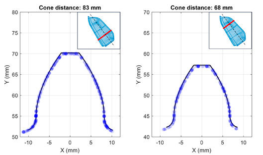

A simple approach to validate the identified macrogeometry is to compute, in a transverse section defined by its cone distance Rm all the geometrical parameters of the equivalent cylindrical spur gear. From there, using equations for involute profile and trochoidal root, one can compare the theoretical tooth shape with the physical points of the scanned dataset at the defined section. This comparison is illustrated in Figure 7, where the theoretical tooth shape is represented as a dark continuous line, while the physical scanned points appear as blue scattered points. The comparison is performed at two different cone distances—close to the toe and heel of the planet gear—both different from the one at which the analysis was conducted.
Figure 7—Theoretical tooth shape vs. transverse section points.

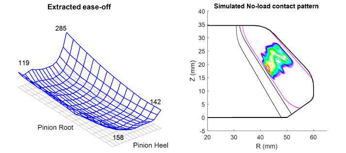

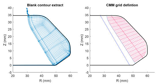

Topographic Measurement and Contact Ease-Off
In this final section, the gear blank shape was extracted from an RZ projection, capturing parameters such as the back cone angle, root reinforcement and tip radii, as shown in Figure 8 (left). Using this data alongside the previously determined macrogeometry, an initial approximation of the tooth surface microgeometry was established.
To refine this approximation, a 15 x 15 measurement grid was created, precisely following the gear contour, as depicted in Figure 8 (right). Each grid point contains x,y,z coordinates and the normal to the tooth surface.
Figure 8—Blank contour extract, CMM grid and contact ease-off.

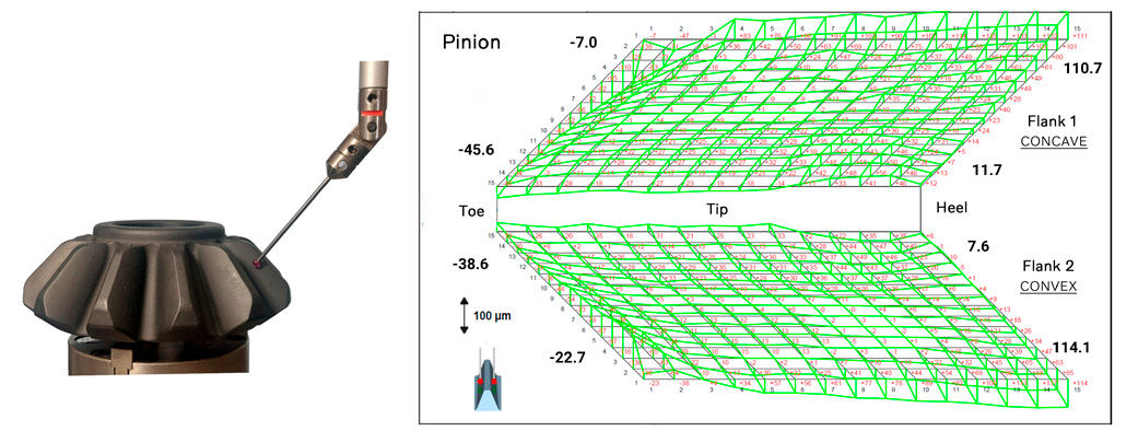

The planet gear analyzed in this study was then placed on a coordinate measuring machine (CMM) to measure the exact surface deviation at each point in the normal direction, as presented in Figure 9 (left). The CMM inspection report (Figure 9, right) revealed reasonable amplitudes of the surface deviation, confirming the validity of the initial microgeometry assumption. The final microgeometry was determined by combining the initial estimation with the measured deviations.
Figure 9—CMM evaluation and inspection report.
Applying the same method to the side gear enables the determination of the geometric ease-off. The extracted ease-off topography is represented on the pinion in Figure 10 (left) as the initial gap (in µm) between mating gears. From this, standard finite element (FE)-based bevel gear calculation can be performed, enabling the accurate evaluation of durability under load, contact patterns, transmission errors and overall performance. An example is provided in Figure 10 (right), illustrating the simulated no-load contact pattern on the planet gear.
Figure 10—Extracted ease-off (gap in μm) and simulated no-load contact pattern.
