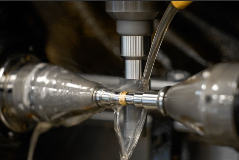

The AF140 was developed in close collaboration with users and industry partners to meet the growing demand for simplicity, compactness, versatility, and ingenuity in gear hobbing. Designed primarily for the watchmaking sector, the machine is equally suited for precision applications in micromechanics, aerospace, automotive, micromotors, robotics, and medical technologies.

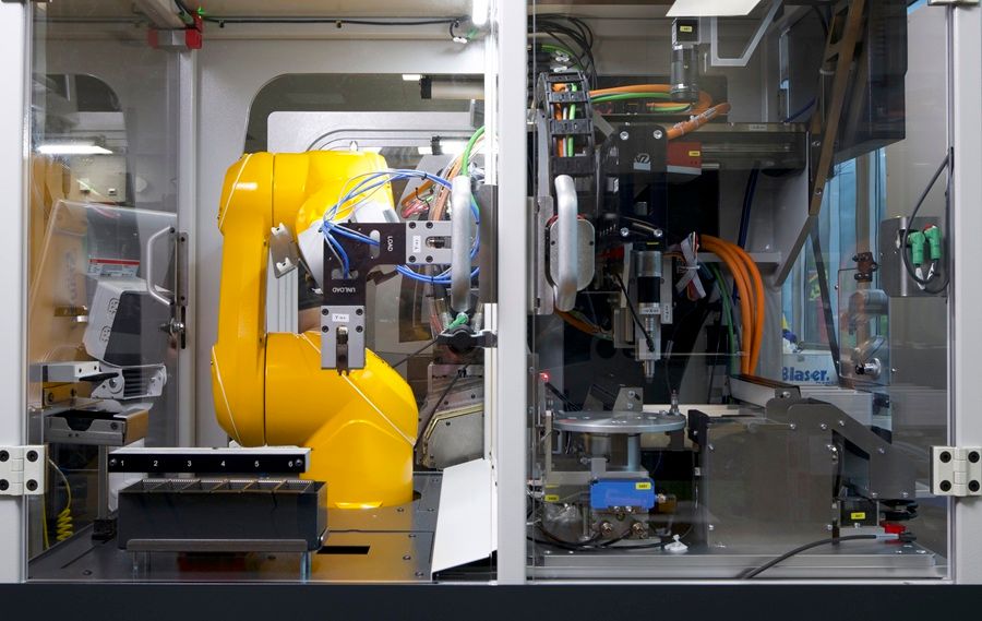

The AF140 reaches cutter rotation speeds of up to 16,000 rpm and workpiece rotation speeds of up to 5,000 rpm. The new and customizable robotic arm option for automatic loading and unloading significantly boosts the productivity of the AF140, enabling seamless automation and reliable 24/7 production. At the same time, the machine remains fully compatible with established loaders such as W20, W25, W31, AF45, deburring units and more. Built on the powerful Pegasus CNC platform, the AF140 provides digital integration with IO-Link sensors, simplified commissioning, and advanced remote service for real-time support and updates.
