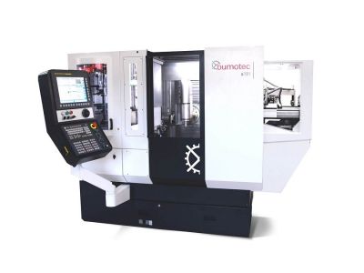

The demo center will be at Amorphology's Pasadena, California, headquarters where Starrag Bumotec's s191H CNC machine will be showcased, machining a wide variety of parts from mold inserts to rapid prototype gears, as well as other production BMGs and traditional metal parts.

"The Bumotec s191H provides mill-turn capabilities as well as a higher production capacity," said Riley. "Bumotec can take our alloys and machine single pieces. Or instead of machining one part at a time, it can produce hundreds of pieces lights-out."
