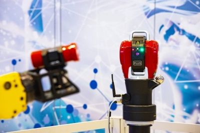

The delivered solution includes API’s 6 DoF (Degrees of Freedom) RADIAN Laser Tracker complimented by the API Smart Track Sensor, which mounts directly to the robot’s end effector, allowing the laser tracker to dynamically collect X, Y, Z, and I, J, K data for each robot position in space accurately and automatically.
The robot is automatically driven to discrete positions using API’s Robot Performance Measurement (RPM) Software providing fully automated measurements and data acquisition and allows customization of the actual workspace under calibration. Up to 30 robot parameters can be calibrated in a completely automated run-time.
