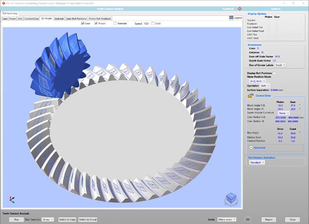

Bevel Gears
Traditionally speaking, the closed loop for gear use were designed for bevel gears. The traditional cutting processes used for bevel gears, known as face-milling or face-hobbing, intrinsically involve adjustment of cutting and machine parameters, which is itself a closed loop. Modern cutting simulation techniques prior to checking the contact pattern on tester (Figure 2) have made production times quicker, but the concept has remained more or less unchanged, as described by Refs. 5 and 6.
Figure 2—Simulation of the contact pattern (Ref. 7).
However, not all bevel gear designers have dedicated machine tool software.
In this case, they follow in the footsteps of Socrates: they know that they know nothing (Ref. 8). They can limit themselves, in the first instance, to only establishing the module and number of teeth, as well as the pressure angle (often 20 degrees or 22.5 degrees), the spiral angle (almost always 35 degrees), and face width (approximately one-third of the outer cone distance) values. It is almost embarrassing to think that the tooth thickness and tooth root radius, which are considered so carefully for cylindrical gear wheels and so important when calculating the bending strength, are ignored when designing bevel gears. Even if standards to calculate strength for both cylindrical (ISO 6336 and AGMA 2001) and bevel gears (ISO 10300 and AGMA 2003) require the values of both tooth thickness and tooth root radius or provide formulas to calculate them (AGMA 929), designer of bevel gears are not always able to fix these values in the drawings.
Most of the time, bevel gear designers that do not have dedicated machine tool software try to guess what the face angle of blank and the root angles will be, as well as tooth thickness, possibly wishing for a full radius for the tooth root. At the present time, the freely accessible bibliographical source offering the most realistic definition of the final geometry of spiral face milling is Ref. 9.

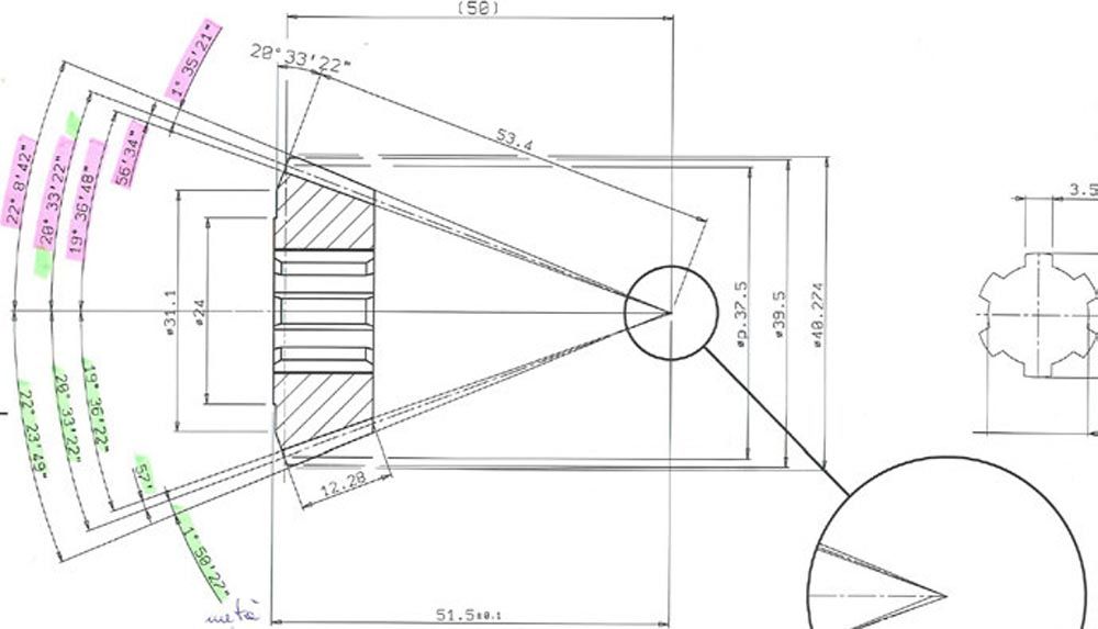

Figure 3—Drawing of a bevel gear: on the top side, there is the initial dimensioning (all apexes are in the same point). On the bottom, there are dimensions from the workshop.
In some cases, the drawing comprises two stages and keeps track of the effect of the closed loop as shown in Figure 3. The top half shows the geometry defined by the designer, while the bottom half shows the actual geometry, taken from the dimension sheet generated by the workshop.
In other cases, the same drawing of the bevel gear pair with only basic data is sent to many suppliers. Each of them cuts according to different parameters (Table 1). The same spiral gear pair is manufacturing with different geometries and so with different strength. In this case, the technical department cannot send a realistic calculation report to customers or to certification bodies.
Table 1—Three different cases of Duplex Helical Spiral Bevel with the same number of teeth (13–51), module (4.126), facewidth (30 mm), and pressure angle (22.5 degrees).
This primitive closed loop for bevel gears, which limits itself to intervening in the design process prior to part manufacture, in other words to intervening exclusively in the definition of specifications, could terminate with the microgeometry grid obtained by GMM being transferred to the design software.
