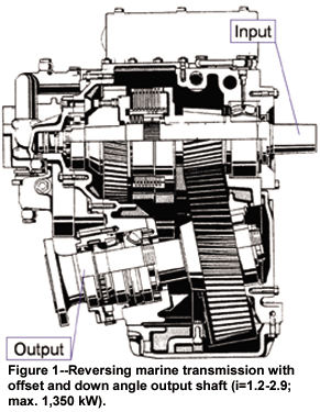

-Marine transmissions with down-angle output shafts (Refs. 1 and 3, Fig. 1); and

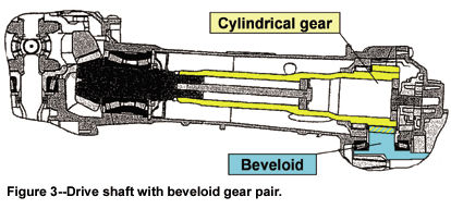

ZF has developed a six-speed AWD automatic transmission for high-end passenger cars with 750 Nm of torque. For the first time, AWD has been realized for a six-speed automatic transmission. For this project, the AWD concept of VW/AUDI with Torsen differential (Ref. 4) was optimized, functions were improved, and the number of components and tooth engagements was reduced.
Originating from the planetary gear, the power flows via a spur gear to the Torsen differential, where the torque is distributed to the cardan shaft (50%) and via an intermediate stage to the front-axle bevel gear (50%), as shown in Figure 2. The skew drive shaft is an indispensable benefit of the package. With a parallel drive shaft arrangement, the tunnel dimensions would have been too big to permit realization of a right-hand drive vehicle. The skew drive shaft was made possible by a beveloid gear and an adapted bevel gear (85° shaft angle).
Transfer gear and bevel gear share a common oil circuit. Lubrication is effected via a separate oil pump, which is driven via the drive shaft, as shown in Figure 3. Development of this beveloid gear is described below.

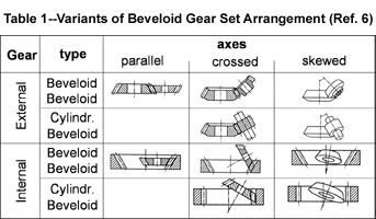

Gear set arrangements. Beveloids can be installed in the following axis configurations:
-parallel axes,
-intersecting axes and
-skewed axes.
Due to the fact that selection of the cone angle does not depend on the shaft angle, pairing is also possible with cylindrical gears. Beveloids can be produced as external or internal gears, as shown in Table 1, so a whole matrix of pairing options results, and the designer is provided with a high degree of flexibility (Ref. 6).

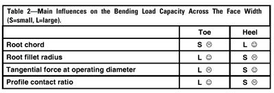

Load capacity calculation. Certain conditions provided, analytical calculation methods for involute spur gears, such as ISO 6336, DIN 3990 or AGMA C95, can be used for sufficiently accurate determination of the load capacity of beveloids in intersecting axial arrangement. This is, however, only possible if the tooth contact is linear. Since the tooth contact of most beveloid sets without flank modifications is point contact, flank modifications must bring about approximate linear contact.

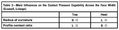

The tooth profile changes across the face width, and consequently load capacity in the individual face sections across the face width changes. The main influences on tooth root capacity change across the face width in opposite directions, which are shown in Table 2.
Homogenous tooth root capacity across the face width is to be aimed at. The influences on flank capacity also vary across the face width, as shown in Table 3.
The load capacity of the tooth center section can thus be seen as representative for the entire gearing. All geometric gear parameters are determined in the tooth center. Only the center distance must be converted into a substitute center distance as and is obtained by adding up the pitch radii.

For a six-speed automatic transmission with integrated AWD, a beveloid gear set with 8° shaft angle was developed for a skew drive shaft linked to the front axle, as shown in Figure 16.
This permitted compact tunnel dimensions. Since mid-2002, the transmission has been in production in a high-end passenger car. Development work included the following tasks:
