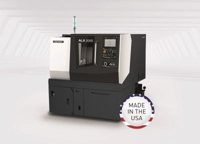

ALX 2000
Modern equipment options, compact dimensions, and a high level of automation all contribute to the efficiency of a turning machine. DMG MORI has considered this in the development of the ALX series to meet the high demands of serial production in the automotive and other sectors. The ALX 2000, a U.S. premiere that DMG MORI produces locally in Davis, is a stable, dynamic, and compact turning machine that combines excellent standards from a max. spindle speed of 4,500 min-1 to the BMT turret with twelve powered tools and tailstock. In addition, the ALX 2000 offers a high degree of automation thanks to the optional gantry loader, a deciding factor for cost-effectiveness in production.
