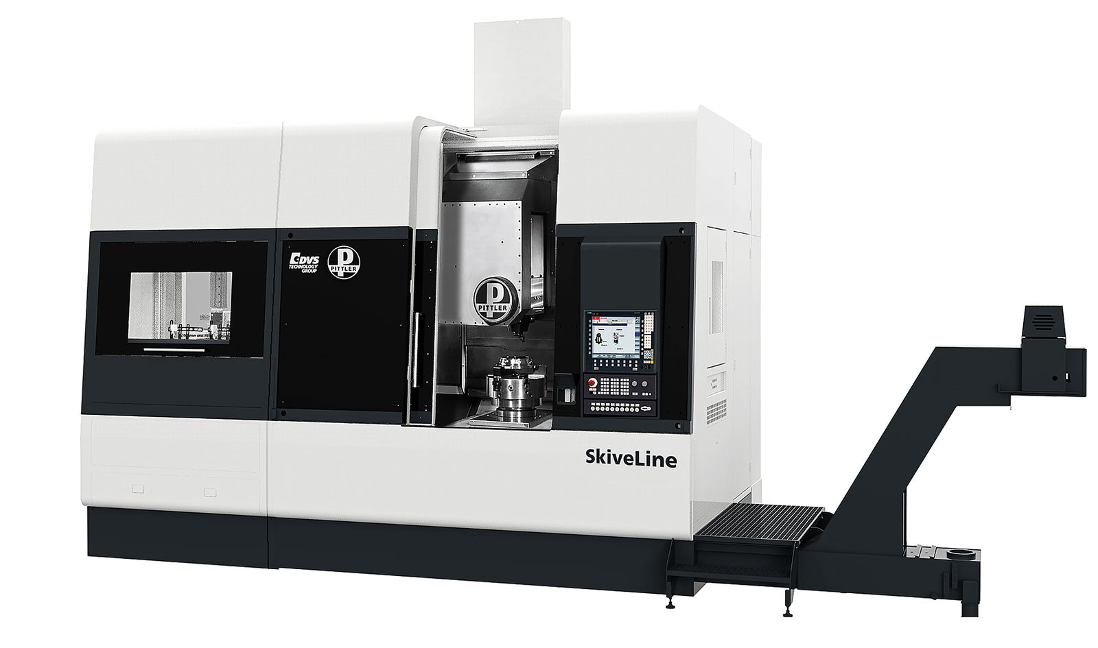

PITTLER SkiveLine— The Compact Multi-Talent
The SkiveLine offers Power Skiving in conjunction with complete machining. An integrated tool magazine allows this efficient gearing technology to be presented without compromise in a 5-axis machine alongside the process of turning, milling, drilling, grinding, thread cutting, and measuring. The flexible use of technology allows machining with a maximum of two chucking processes.
PM_IMTS_2022_DVS TECHNOLOGY GROUP_07092022.jpgThe power of SkiveLine by Pittler, a brand of DVS TECHNOLOGY GROUP.
