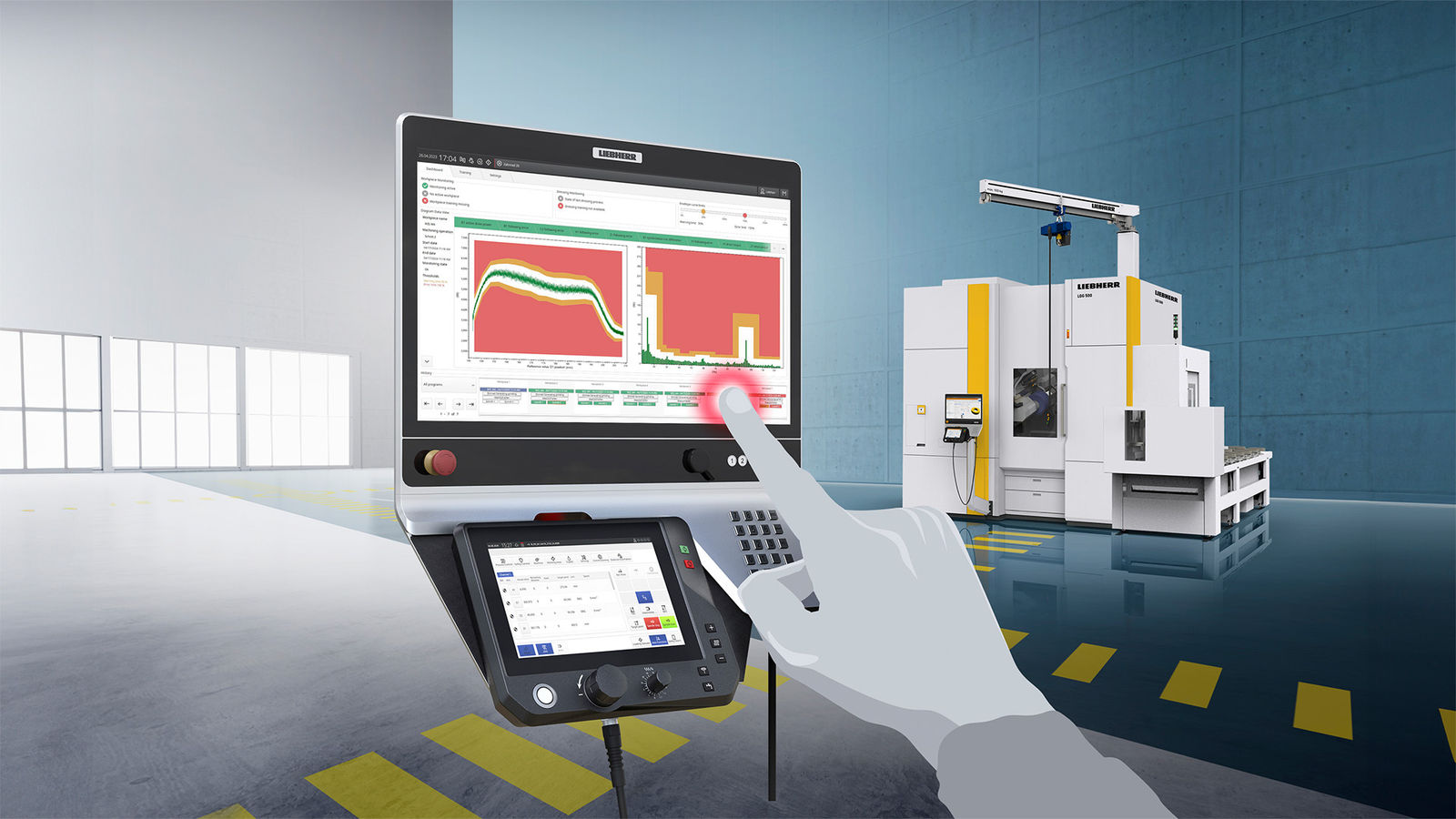

Clear visualization of parameters, warnings and limit violations.

The LHProcessMonitoring software from Liebherr-Verzahntechnik GmbH for inline process monitoring visualizes the manufacturing process and uses the data obtained to determine limit values in the form of envelope curves, which are used to check the manufacturing process. These can then help identify any deviations that could lead to noise anomalies. The software is optionally available as part of the LHGearTec operating and programming interface, and is therefore “the logical continuation and expansion of our product portfolio of digitalization modules with a focus on e-Mobility,” says Florian Schuon, head of digital solutions at Liebherr-Verzahntechnik GmbH.

Thanks to continuous recording and transparent evaluation, the software enables the operator to optimize and stabilize the manufacturing process. Limit violations are automatically detected, and do not enter the value chain. LHProcessMonitoring ensures the consistent quality of each individual gear and can replace a downstream full inspection that uses a single flank gear testing system or master gear, which in turn saves investment and set-up costs—all at a comparatively low investment. At the same time, a significantly higher degree of accuracy is achieved. “It’s often only at the end of the supply chain that you realize something is wrong. Our software improves the traceability of parts at an early stage, not just during the EoL inspection. Manufacturers of conventional gearboxes also benefit from the improved gear quality,” says Schuon, explaining the advantages of the software.
Dynamic Envelope Curve Analysis
Like the LHGearTec, the LHProcessMonitoring software also has an intuitive graphical user interface. It evaluates the parameters of the drive motors, and limit values can be easily set using a slider. Dynamic envelope curves indicate warnings or stops in the event of limit value violations, while signals from individual parameters such as motor position, power and torque allow direct conclusions to be drawn about the source of the fault. The machine is “trained” using reference parts and immediately informs the operator of any deviations or anomalies, so that faulty parts don’t make it to the EoL test stage. The software is initially available for generating grinding, profile grinding, and skiving, and it can also be used for dressing. In the future, it will also be extended to other gear cutting methods.
