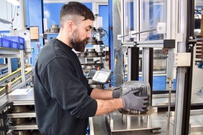

Overall, a very safe and quick process is put into effect around the custom-designed Uni Heat system: The operator grabs the empty housing with protective gloves, places it in a custom-fit workpiece carrier and pushes it inside the machine. By closing a sliding door, he starts the following process: The component moves upward into its home position. This leads the induction rod to “plunge” into the empty housing enclosure. The subsequent heating process lasts only 30 to 120 seconds depending on the size of the component. Once it is completed, a warning lamp signals to the operator that the component can be removed. He places it in a mold, which is ready at the cooling location, and pushes the motor winding from the top inside. After a short cooling process, the motor is fully combined and ends up on a conveyor belt to the next processing step. “We produce about 250 motors per day in this way,” says Steffen Müller from quality assurance at Elektror. “The component sizes change regularly and yet the process stays perfectly stable. There are absolutely no issues or faults.” Which is partially due to how simple it is to retool the machine in the event of a component change: The operator closes the water supply, loosens two screws on the inductor mount and can then remove the tool and replace it with a new one. The workpiece holder is merely set down and can therefore, easily be removed from its support and replaced. “Including the program change on the control module, the entire retooling process lasts only about one minute. Various safety features prevent operator errors,” says Müller.
