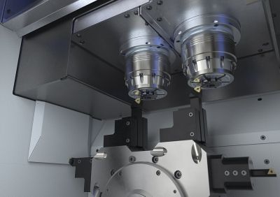

Bevel gears found in passenger vehicles are mass-produced. Supply companies produce these gears, essential for differentials, by the million—and it’s no wonder, since there are four of these in every differential. The number of all-wheel-drive vehicles, which include two differentials each, is continuing to rise leading to an increase in bevel gear output volume and bringing more attention to the production process for this part. Supply companies are searching for new mechanical engineering solutions that guarantee considerably lower costs per piece and a consistently high quality. With its twin-spindle pick-up turning machine—VL 1 TWIN, EMAG has developed a solution: It simultaneously machines two identical bevel gears at high speed within the same machining area. A robot cell and swivel table can easily load this machine. All this brings the cycle time down to 4.5 seconds.

The basic principle of this pick-up turning center plays a decisive role. It features two pick-up spindles (9.9 kW/136 Nm at 40% duty cycle) that are used to always machine two identical bevel gears in parallel at high speed (OP 10 – OP 10). The two spindles load and unload the machining area in just five to six seconds. The machining steps described above are then performed successively and in a single clamping operation with a total cycle time of about 25 to 40 seconds (depending on type and size of part). The average chip-to-chip time is just under six seconds. A special clamping solution reproduces the negative image of the component’s gearing and holds it firmly in place for the entire time. Additionally, the VL 1 TWIN is able to drill into solid material, which is how the bevel gear’s center bore is produced.

With EMAG equipment, there are a range of standard features that ensure component quality and reliability. For instance, the VL 1 TWIN has a machine base made of MINERALIT, which significantly reduces vibrations during the turning process, leading to longer tool life and lower tool costs. Headstocks can traverse autonomously, allowing the diameter and length (X/Z directions) of both components to be adjusted independently of one another if there any deviations, e.g., following the change of an indexable insert. The wear-free linear drive in the X-axis, including the direct distance measuring systems, is equally important. It has an acceleration of 8 m/s2 (1,575 fpm) with precise long-term accuracy. The roller guides in all linear axes guarantees further precision.
