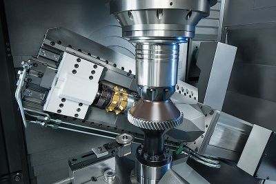

The vertical VL 4 H hobbing machine can be configured for a wide range of applications. The high-performance drives used in the working spindle and the hob enable high speeds and torques, ensuring fast, precise and cost-optimized gear production. The machine allows the dry gear hobbing of workpieces up to 200 mm in diameter and module 4. The optional measuring system for part alignment can be expanded by adding a sensor system for positioning. It is installed outside the machining area where it is protected from chips and dirt; it can also be extended and retracted as required. This not only allows adjustments to be made to the machining operations at any time, it also permits seamless documentation for production quality assurance.
The machining area of the VL 4 H is easily accessible through the large front door, allowing rapid set up times and creating an ergonomic work environment for the operator. The combination of powerful drives, a working spindle that can be controlled with absolute precision, tool clamping, and the generously dimensioned machining area allows various different gear cutting methods to be used on the machine. For instance, the chamfer cut method can be used to chamfer the workpieces directly after hobbing, with a single clamping operation. To do so, the chamfer cut tool is mounted on the hob arbor of the cutter in addition to the hob. The chamfer cut method, developed by Fette, is ideal for precise and low-cost chamfering processes. "As this method does not produce any secondary burr and does not warp the material, it is especially useful for gear teeth that are honed after hardening," said Jörg Lohmann, head of sales at EMAG Koepfer. To be effective however, the workpiece does have to have a suitable shape, however. "We have successfully tested this machining combination in the manufacture of gears. The wheel-shaped workpieces have hardly any interfering contours, so that chamfering with Chamfer-Cut is possible. The machining combination of hobbing and chamfering in a single clamping operation, on one machine is a very cost-effective solution for the user, as two manufacturing processes can be carried out at the same time with just one machine, and the workpiece handling between the processing steps is also eliminated. That lets you reduce your floor to floor times and get workpieces to the next production step faster," Lohmann explained.
