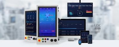

2. Smartphone Like Dashboard
Of course there are questions regarding the usability of the entire approach—and the term “app” is already a good first sign: The front-end design of the EDNA Life Line dashboards is based on modern tablets and smartphones. “Users already know the underlying operating philosophy from their daily lives. This means that they can learn how to use the operating interface much faster, which in turn has a positive effect on process reliability,” explains Ricarda Schuhmann, who is responsible for design and strategy at intuity, one of EMAG’s development partners. A first glance the dashboard immediately confirms this assessment: Data is presented in appealing visualizations in individual widgets. Users can determine what exactly is shown and in which layout. The clear structure pays off—quite literally: Early warnings are signaled for anomalies, the end of tool lives or machine wear. This prevents overlooked rejects and unplanned downtimes. Production planners, operators and others have access to the dashboard from anywhere—for example on their smartphone. “Three basic principles governed our joint development: simplicity, consistency and networking,” adds Lukas Siegele from intuity. “The end result embodies these principles in every respect. It lays the foundation for the chaotic and fully networked production of the future.”
