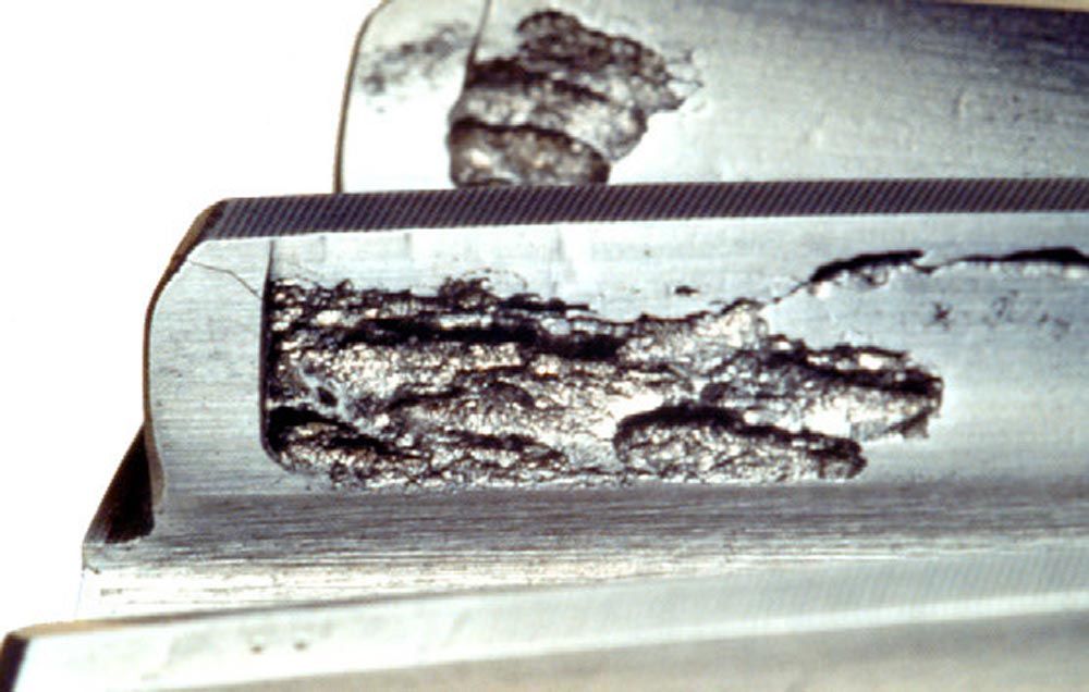

Broadly speaking, all AGMA standards and information sheets are concerned with gear failure, but in the narrow sense, AGMA has two gear failure-specific definition documents that need to be mentioned. Every gear engineer should be familiar with ANSI/AGMA 1010-F14, Appearance of Gear Teeth—Terminology of Wear and Failure. This standard identifies and describes common gear failures and offers recommendations to avoid the failure modes. The current, 6th edition was published in 2014 with 89 detailed color figures showing gear failures over 81 pages. This is quite the leap from the first edition, titled AGMA 110.01, published in 1943 with 20 black and white pictures within 10 pages. AGMA’s other failure nomenclature document is AGMA 944-A19, Mechanisms of Powder Metal, PM, Gear Failures. It is written similarly to ANSI/AGMA 1010-F14 but covers powder metal gear-specific failures over 30 pages and includes 11 detailed color figures. AGMA’s goal for the next revision of ANSI/AGMA 1010 is to incorporate powder metal gear failures and expand the standard to include plastic gear failures—definitions never published by AGMA before.
