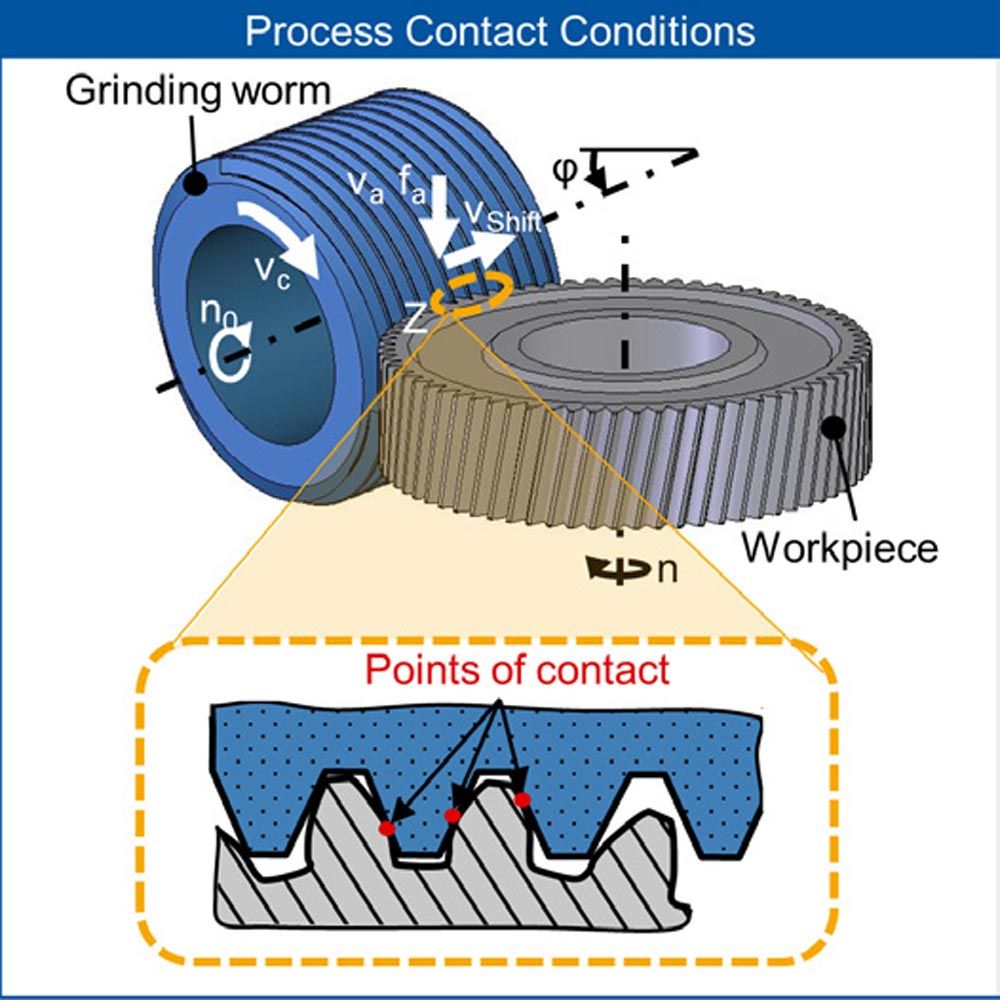

Generating gear grinding is one of the most efficient processes for hard finishing of gears. In the process, the cylindrical grinding worm whose profile equates to a rack profile in a transverse section meshes with an external gear (Ref. 1). The involute of the gear is generated by the continuous generating motion of the grinding worm and workpiece by the profile cuts method. One special characteristic of the process is the multiple points of contact between the grinding worm and the gear, Fig. 1. The number of contact points changes continuously during the tool rotation (Ref. 1).
Figure 1—Generating gear grinding process.
Based on the grinding worm topography, process parameters, and process kinematics, the microinteraction characteristics are different for each grain. Ultimately, these differences influence the force and the energy in the contact zone. To predict the force and energy of the process, simulation models have been developed in the last years, considering the complex kinematics of generating gear grinding as well as the microinteraction characteristics (Refs. 8, 9, 10). One of these simulation models will be reviewed in the next section. Furthermore, a review of the microinteraction characteristics currently considered in the software for the calculation of the forces is performed. In addition, the calculation of the energy for generating gear grinding considering the microinteraction characteristics is described and reviewed.

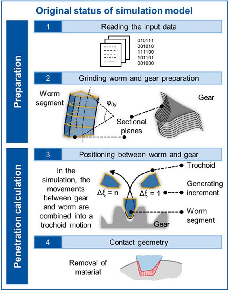

The simulation is performed in several steps. In the first step, input data such as gear and tool geometry and process parameters are read. Next, models of the grinding worm and the pre-cut gear based on sectional planes are generated. The sectional planes in the grinding worm represent the tool profile. To keep the computational effort as low as possible, only a segment of the actual grinding worm is considered for the simulation, defined by an opening angle of φ0y, middle of Figure 2. In the next step, an abstraction of the actual process kinematics was introduced in the simulation model, to decrease the complexity of the modeling. In the abstracted kinematics, the grinding worm segment is positioned relatively to the gear, following a trochoid curve. The trochoid-generating motion of the grinding worm of the simulation model represents a combination between the movements of the gear and tool, occurring in the real process. Despite the kinematics abstraction, the same contact conditions and material removal to the real process are achieved in the end of the simulation. The trochoid-generating motion is discretized along the process by a defined generating increment Δξ. Between the first and the last generating increment Δξ, a complete machining of the tooth gap’s sectional planes is performed. The contact geometry between the grinding worm segment and the gear is calculated for all discrete generating positions, in the lower middle of Figure 2.
Now, the simulation model only considers the macro interaction of the tool and the gear. However, for an accurate energy and force calculation, the microinteractions between the grinding worm and the gear are also of high relevance. The abstraction of the process kinematics used in the simulation model, without an accurate representation of the tool rotation and the cutting speed, makes modeling of microinteractions not possible. The rotational movement of the tool surface has a significant influence on the grinding worm topography interaction with the material. The rotational movement is essential for the generation of the path of contact between grains and gear during the process, and it cannot be neglected in the simulation if the microinteractions should be analyzed.

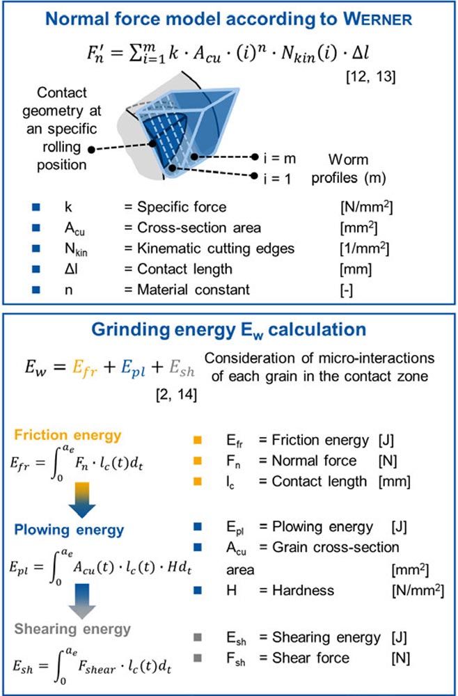

In the work of Hübner, an investigation of the normal force calculation considering the engagement of the grains with the help of the simulation model (see “Modeling for Generating Gear Grinding”) was performed (Ref. 12). In his work, the normal force model developed by Werner was transferred to generating gear grinding (Ref. 13), see equation shown in the upper of Figure 3. Except for the specific force k, all the variables were calculated in the simulation model. In the work of Hübner, the grinding worm topography was modeled by means of measured 2D contours of individual grains. Those individual grains were subsequently mapped onto the grinding tool profile manually. While this approach can be suitable for monolayer galvanic grinding tools, the irregularities of the grain distribution of vitrified grinding worms are not reproduced accurately. Therefore, the approach used by Hübner, did not consider two important factors of the grinding worm topography. The first factor is the different protuberance of the grains from the grinding worm topography, which leads to the situation where not all the grains from the grinding worm topography are in contact with the workpiece. The second factor is the shadowing effect during the contact between the workpiece and the grinding worm. The shadowing effect characterizes the influence of the first grains in contact with the material on the engagement of the grains which are in contact with the material immediately afterward.
Figure 3—Calculation of force and energy for generating gear grinding process from previous research.
The process energy Ew corresponds to the energy required to remove material and is commonly assumed to be equal to the spindle energy (Ref. 2). In the previous work of Teixeira, an energy model considering the chip formation mechanisms of the engagement of one single grain for generating grinding was proposed (Refs. 14, 15). This model was based on the work of Linke, where the energy of each chip formation mechanism was calculated differently, considering its specific aspects for the process of surface grinding (Ref. 2). In the model of Teixeira, the work of Linke was expanded for the process of generating gear grinding, upper right of Figure 3, and single-grain trials were performed for validation. A more detailed description of the calculation method for the energy of each chip formation mechanism can be found in (Ref. 14).
For the calculation of the energy of each chip formation mechanism, information regarding the microinteraction characteristics of the grains, such as contact length lc, grain cross-section area Ac and chip thickness hc are required. In the end, the process energy Ew was calculated as the sum of all the energies from each chip formation mechanism, of all the grains engaging in the material, upper right of Figure 3. Even though different research has been performed on the topic of simulation models for force and energy for generating gear grinding, an investigation of the microinteraction characteristics using more realistic modeling of the grinding worm topography while considering the complex kinematics and tool rotation movement of the process is required The consideration of tool topography and grinding worm rotation will enable a more detailed calculation of the energy for generating gear grinding process.

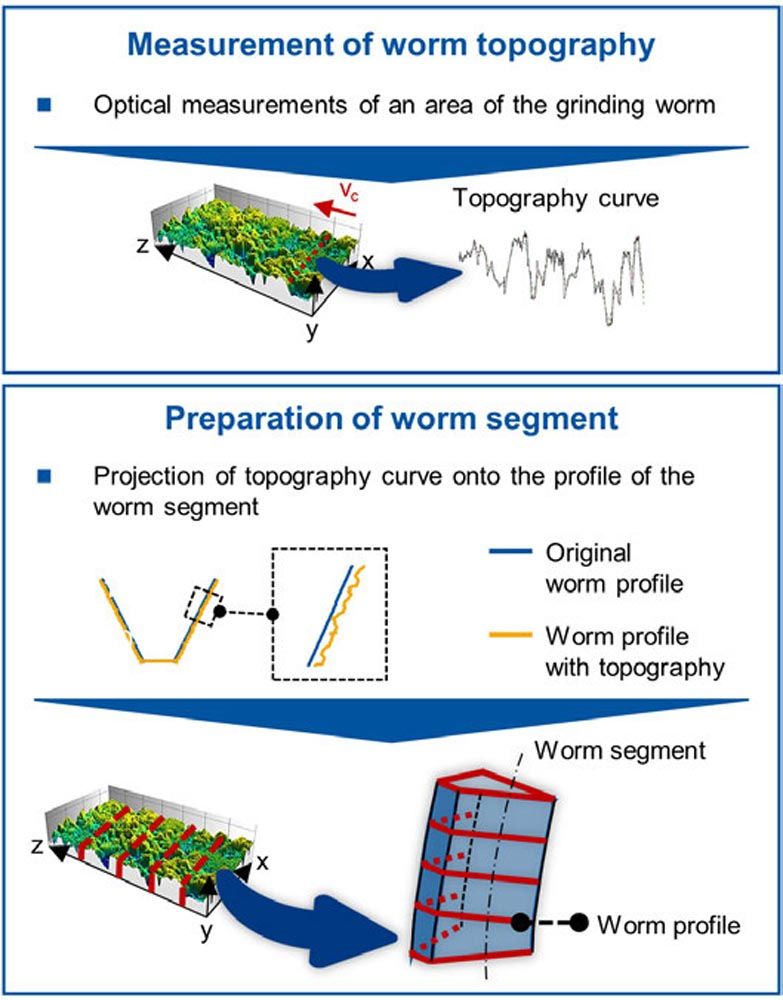

The first step is an optical measurement of the grinding worm topography with a laser scanning microscope. The measurement is performed with a resolution of 20x, in an area of the grinding worm large enough for a representative sample of the entire grinding worm specification. The optical measurement is analyzed with the support of the software MountainsMap. In the software MoutainsMap, topography curves are extracted in several positions along the z-axis, Figure 4. Next, the topography curve is brought onto the worm segment. The worm segment, shown at the bottom of Figure 4, is formed by sectional planes called tool profiles. Each topography curve of the real grinding worm is projected onto one different tool profile. In the end, the topography of the real grinding worm will be represented in the worm segment used in the simulation model.
The second extension required in the simulation model is regarding the grinding worm rotational movement. The worm segment is positioned relative to the gear following a trochoid motion. In the original version of the simulation model, the position of the worm segment changes along the simulation, but the worm segment itself does not change or rotate. In addition, all the tool profiles of the worm segment are the same. In the extended simulation model, each tool profile from the worm segment has a different topography curve. The rotational movement of the worm segment is implemented by a change in the position of each tool profile during the simulation, see Figure 5.gt0523_Page_56_Image_0002.jpg

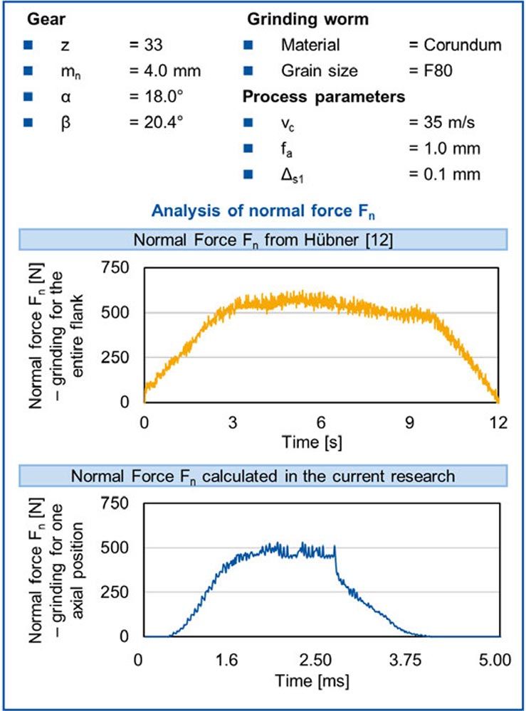

After the extension of the simulation model, the microinteraction characteristics of all the grains engaging with the gear during the process are obtained. With the microinteraction characteristics from the simulation model, the normal force Fn for generating gear grinding is calculated, based on the model of Werner (see Figure 3) (Ref. 13). To verify if the microinteraction characteristics used for the force calculation are suitable, the normal force Fn calculated in this work is compared to the results from the model developed by Hübner, which was already validated by means of experimental trials (Ref. 12). A simulation with the extended simulation model is performed, with the same parameters used in the work of Hübner (Ref. 12). The diagrams in the lower part of Figure 6 show the normal force Fn calculated in the work of Hübner, upper diagram, and the normal force Fn calculated using the model in the current work, lower diagram.
Figure 6—Analysis of the generating gear grinding normal force calculation.
In the simulation model, a type of simulation called fast simulation is possible. In this type of simulation, only one area in the middle of the gear flank is considered, where full contact between tool and gear occurs. The simulation represents only one axial position of the gear gap and only the maximum values of the process characteristic values are calculated. In his work, Hübner was able to validate the normal force Fn calculated by means of experimental trials. The diagram shows the normal force Fn calculated by Hübner, during the grinding of a gap in the entire flank. The next diagram shows the normal force Fn calculated in the current work, during the grinding of a gap in only one axial position.
A comparison between the normal force obtained by the extended simulation model and the model developed by Hübner shows good accordance. It is possible to assume that the microinteraction characteristics calculated by the extended simulation model are in accordance with the real process.
