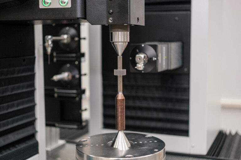

Forest City Gear is proud to announce the addition of a Kapp Niles KNM 4X analytical measuring machine to its inspection department, further expanding ability to inspect high-precision gears, gear tools, and rotationally symmetric workpieces. Designed for small- to medium-sized components up to 450 mm in diameter and 500 kg, the KNM 4X brings a new level of speed, stability, and measurement confidence to Forest City Gear’s inspection process.
The KNM 4X has advanced rotary axis alignment capabilities, giving Forest City Gear an important edge in high-precision inspection. Unlike traditional datum feature referencing, this software-driven process uses the probe to automatically remove any mechanical misalignment before measurement begins. The result is cleaner, more reliable data—a proven advantage for both ultra-accurate inspections and complex troubleshooting efforts.
In addition to its technical strengths, the machine plays a strategic role in Forest City Gear’s long-term planning. It helps relieve current capacity constraints while supporting an ongoing initiative to standardize the inspection platform across the company. This unified approach will eventually allow FCG to centrally program inspections offline and deploy part programs to multiple machines across the same network, improving throughput, consistency, and overall efficiency.
