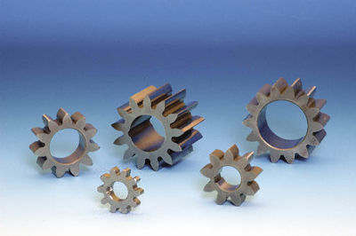

“On bore-type gears,” he says, “we have found that honing the bore is a good way to improve quality in the areas of size, roundness, straightness and finish, without adding a lot of extra cost. The customer notices the difference in a smoother, quieter, more efficient drive.”

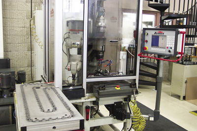

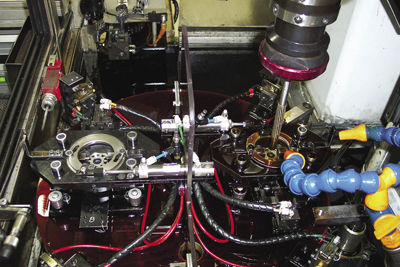

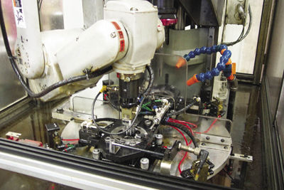

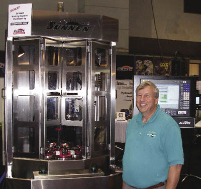

Depending on the production needs for a specific gear, Forest City Gear hones at various points in the manufacturing process using three different systems. One of those systems—a fully automated vertical machine—uses Sunnen’s patented Krossgrinding® tools, which the manufacturer says are capable of controlling bore size down to 0.00005" and finish to 16 µin or better.
