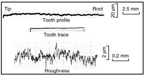

The nylon helical gears were hobbed. Their tooth profiles were not highly accurate, as shown in Figure 4. The nylon gears are easily machined. The nylon’s properties are shown in Table 2.
Figure 4--Tooth profile of nylon gear.
