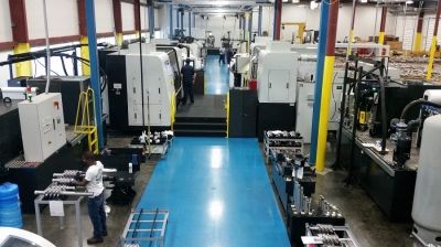

Holroyd Precision Rotors’ new facility in Spartanburg SC covers 35,000 square meters, employs approximately 30 staff locally and is supported by a team of specialist engineers from Holroyd’s HQ in Rochdale, UK.
A wide range of compressor rotors - with overall diameters up to 420 mm and lengths up to 1.5 meters - is manufactured from a variety of materials at the Spartanburg facility. The facility is registered to ISO9001:2015, as are all Holroyd manufacturing locations.
After being first milled and turned to size using high-quality CNC machine tools, rotor blanks are profile milled then precision-ground using Holroyd’s UK-built machine tool technologies. Helical milling is completed using two Holroyd 3EX-R CNC rotor milling centers. Following profile milling and precision cylindrical grinding of shaft diameters, and depending on the components in question, rotor profiles are then finish ground on Holroyd’s TG and Zenith ultra-precision CNC helical grinding machines. Typical component tolerances are within ± 10 µm on profile, lead and divide index.
Designed primarily for the finish grinding of helical screw components after they have been milled to a semi-finished state, Holroyd’s TG CNC rotor grinders are widely recognized for high levels of accuracy and efficient stock removal. Representing the very pinnacle of Holroyd’s profile grinding technologies, the Zenith 400 is one of the first machines of its kind to embrace multiple abrasive-grinding technologies, including vitrified aluminium oxide, ultra-hard plated CBN and ‘dressable’ bonded CBN.
As well as meeting customers’ current compressor rotor manufacturing requirements, each Holroyd machine tool installed in the Spartanburg facility was carefully selected for its ability to fulfil anticipated future manufacturing needs. The 3EX-R rotor milling machines and the TG350E rotor grinding machine, for example, are able to work with components of up to 350 mm in diameter, while the Zenith 400 can grind components of up to 420 mm in diameter, with maximum weights in excess of 700 kg.
