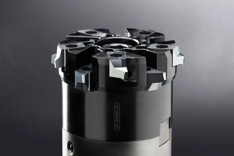

Horn is expanding its tool portfolio for gear cutting to include types for milling PTO shafts. Manufacturers are increasingly focusing on the complete machining of drive shafts. Horn has standardized its own tool range for this purpose, which demonstrates high milling performance. The double-edged carbide insert S274 is used. The program includes tools for PTO shaft sizes 1 3/8" and 1 3/4". The portfolio also includes special milling cutters for restricted shaft clearances. The M274 tool holders are equipped with an internal coolant supply for targeted cooling. The carriers have a diameter of 63 mm (2.48") and 10 teeth.
