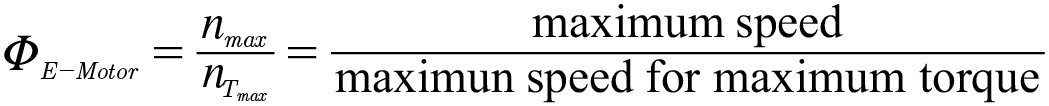

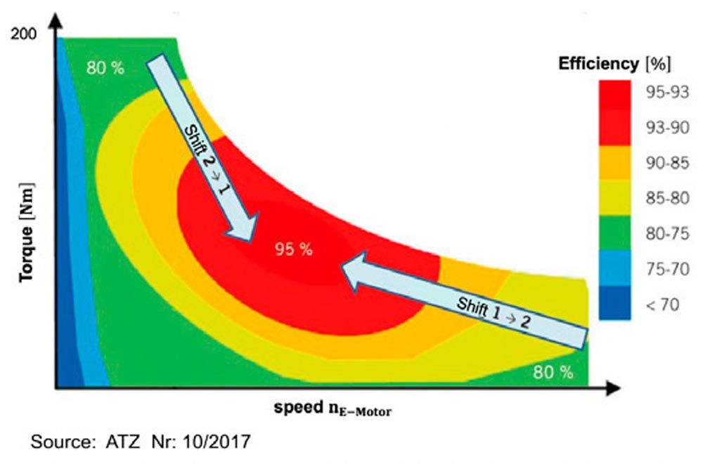

Figure 1 shows an ideal efficiency map for an electric motor, which is designed for a car application. All types of electric motors have nearly the same characteristics. Torque from speed 0 and a long range of speed with nearly constant power. This range can be different from the types of electric motors and depends on their design. You don´t need a clutch or a torque converter for the gap between speed 0 for the car and the minimum speed of an ICE. That is a common problem of ICEs (like gasoline, diesel, or e-fuels), they are not able to deliver torque below their idle speed. The operational range of electric motors with constant power output plays a significant role in transmission design.
(1)
This article appeared in the March/April 2024 issue.
where
ΦE-Motor is ratio between maximum speed and maximum speed for maximum torque
nmax is maximum speed [min-1]
nTmax is maximum speed for maximum torque [min-1]
Another point is the best efficiency of electric motors. How Figure 1 shows that this point will be below the maximum speed of the electric motor nmax and for this ideal example by (roughly) nηmax=2 * nTmax, that means for this example by much lower than the maximum speed of the electric motor. With this ideal map, the method will be introduced to calculate the starting gear ratio, the highspeed gear ratio, and the overdrive gear ratio and with these values deliver the ratio range for the transmission for electric cars.
Figure 1—Efficiency map for an ideal electric motor.
Efficiency deteriorates at constant vehicle speeds when operating in the high-speed range of electric motors. The efficiency of a constant speed of the car will become more important in the future even in Germany with (now!!) no speed limit for highways. If you drive at a constant car speed of 100 km/h you need only 20 kW for this example, which means much less than the maximum power for this electric motor. The overall efficiency ηov can be calculated with Equation 2.

Figure 3 shows the ideal electric motor in a car with a given driving resistance curve (one can use a lot of parameters, which are valid for this curve). The driving resistance curve shows the required power of a car versus car speed. The slipping limit (maximum power) can be calculated with the multiplication of the maximum torque at the axle with the speed of the tires. You can see that, with a starting ratio of about istart E ≈16, the car can only drive about v ~ 105 km/h. Whether this value istart E≈19.4 will be used for maximum acceleration or hill climbing or hill climbing with trailer has no influence. Not until a speed of about 26 km/h can this car accelerate with slipping limit, for acceleration at higher speed you need more power, that is shown in Figure 3.

If an electric car is designed to have only two ratio ranges, the high-speed gear ratio becomes less relevant, because electric motors can produce the maximum power by smaller and lower speeds (Figure 1 and Figure 2). The range Φtr for this example is very high and the step from first gear to the second gear are unusual and for shifting elements too high. Therefore, it is recommended to use the peak-torque of electric motors to reduce the ratio range. The value of the starting gear ratio will be decreased, though that Φtr will become much smaller and suitable for shifting elements. Nevertheless, the ratio range for transmission is smaller than for all known electric motors (Equation 1), which means, if you shift at the high speed of the electric motor after the shifting process you have the same power as before. For calculation of brakes/clutches you should have a look at the patents (Refs. 8, 9).
Figure 6—Efficiency-map of an electric motor with 200 kW ref. to Figure 1, incl. power unit.
In Figures 6 and 7, the ideal motor is scaled up to a power output of 200 kW, using the data from either Figure 1 or Figure 2. For this particular electric motor, the required gear ratio for driving is approximately 1, eliminating the need for a second ratio. This is because the car can achieve speeds exceeding 200 km/h using just the starting gear, as demonstrated in Figure 7. If you aim for higher overall efficiency through overdrive, a two-speed automatic transmission would be beneficial.
Figure 8 displays the overall efficiency, calculated using Equation 2. Compared to the smaller 85 kW electric motor, the efficiency has decreased by about 5 percent because the motor’s optimal efficiency point is not achievable at a constant driving speed. Data points for speeds of 80 and 130 km/h (50 mph and 85 mph) are plotted in Figures 7 and 4. For the electric motor with 85 kW the value of η is ≈ ηmax – 10 percent, for 200 kW this value is η is ≈ ηmax – 15 percent. In the calculations using Equation 2, the transmission efficiency has only a minor impact. When comparing the efficiency of current mass-produced models with the patented example, it is evident that transmission efficiency does not have a significant influence, although it is better than a one-speed transmission.
