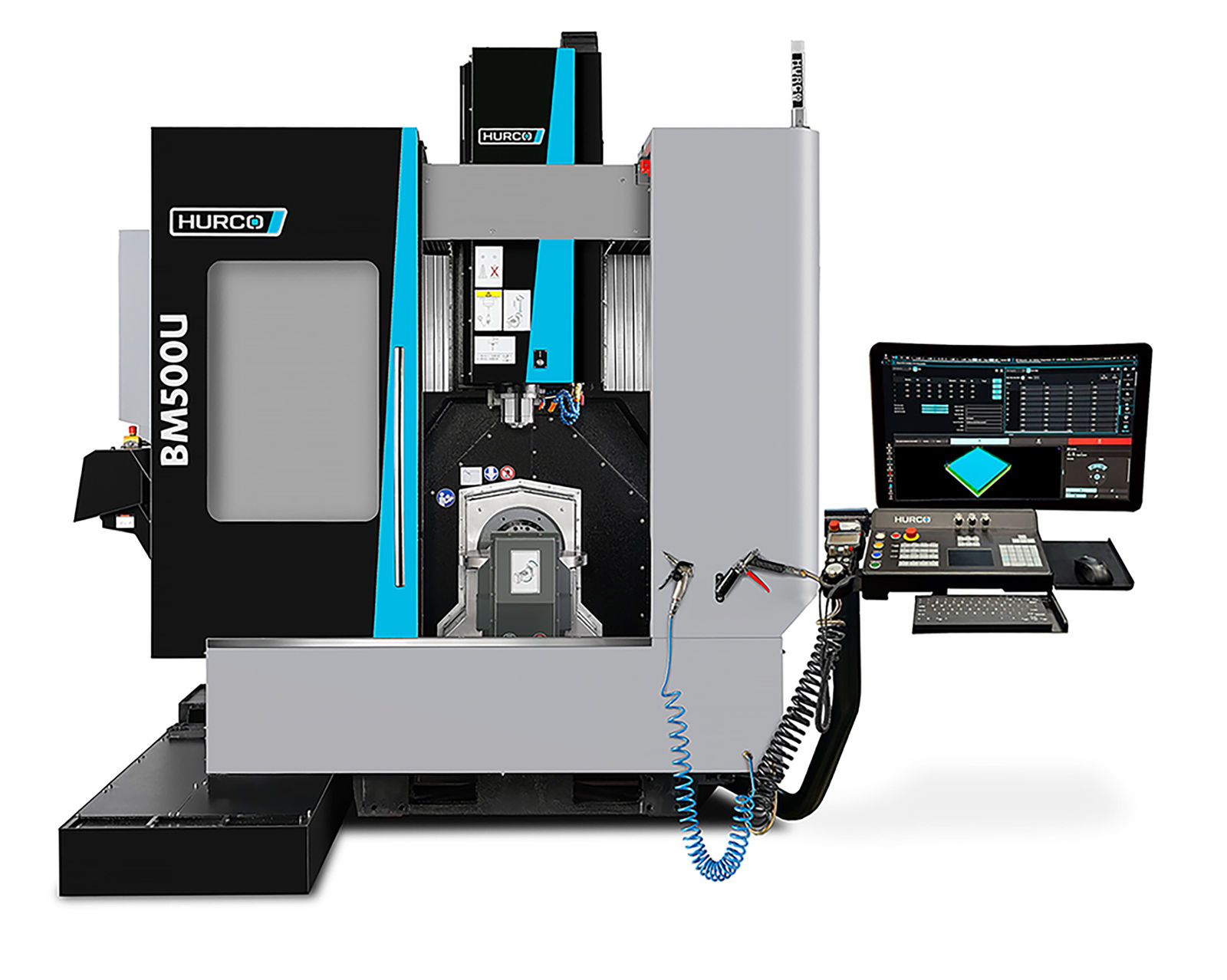

Hurco Cos. announced that IMTS 2026 will mark the debut of its new BM500U 5-axis machining center. Designed for efficient production of complex parts, the machine will be demonstrated alongside a new eight-station automatic pallet changer that facilitates unmanned operation. Both products will be featured in booth No. 338319 at the show.
Capable of maximizing precision across a diverse mix of complex parts, the BM500U uses an integrated trunnion table design that ensures accuracy and allows for increased Z-axis clearance. With an exceptional work-envelope-to-floor-space ratio, the machine includes a 19.7-in. (500 mm) rotary tilt table and X, Y, Z axis travels of 33.5 in. (850 mm) x 19.7 in. (500 mm) x 19.7 in. (500 mm).
The BM500U provides the capability for both 5-axis simultaneous and 3+2 5-axis machining.
A 15,000-rpm, 11-kW Big Plus direct-drive spindle offers robust material removal rates.
Precision and accuracy are ensured by 0.050-μm-resolution absolute linear encoders. To further increase flexibility, an automatic tool changer provides capacity for 60 tools as standard, with a 96-tool version optionally available.
At IMTS, the BM500U will be paired with a rotary-style automatic pallet changer with eight stations. The system uses 12.6-in. (320 mm) pallets that accommodate parts up to 17.7 in. (450 mm) in diameter and 15.7 in. (400mm) in height.
The BM500U also contains a range of standard features designed to boost productivity and flexibility, including linear scales, a spindle cooler, through-spindle air and coolant, flood coolant and an air mist collector.
