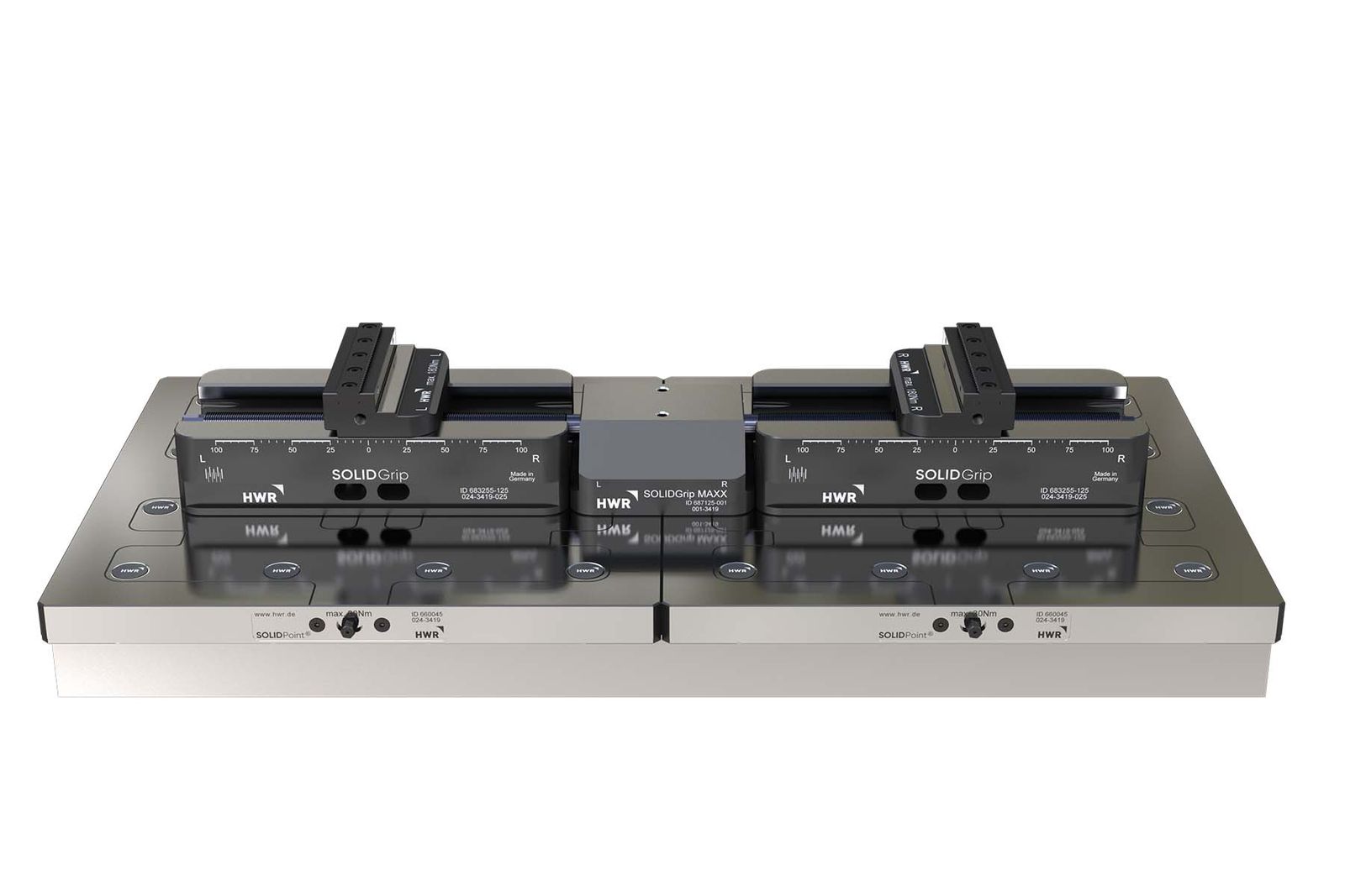

With a maximum clamping range of 800 mm (31.5”), SOLIDGrip MAXX offers extremely secure holding of large parts. The product capitalizes on SOLIDGrip’s modular design, allowing two standard vises to be quickly converted to one large-capacity vise and back again in minutes. For parts that are large in both width and depth, two SOLIDGrip MAXX vises can be applied as a pair. Vise jaws are available in smooth, serrated, and heavy-duty toothed versions to ensure an optimal match to every application.
