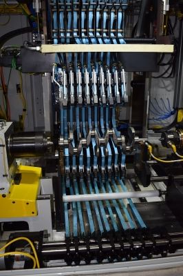

In the IMPCO microfinishing machine, abrasive film is fed through a pair of opposed arms, each holding tooling that is shaped to fit over the part's cylindrical bearing journals. During the process, the arms close around the journals, holding the film against the rotating part for a specified time to achieve the desired surface texture.
The part may undergo several increasingly fine levels of finishing to produce the final finish. The IMPCO machine processes a 4-cylinder crankshaft through three levels of microfinishing plus thrust face finishing. In the automotive industry, surface finish parameters used to evaluate the surfaces of the crankshafts include Ra, Rk, Rpk, and Rvk.
