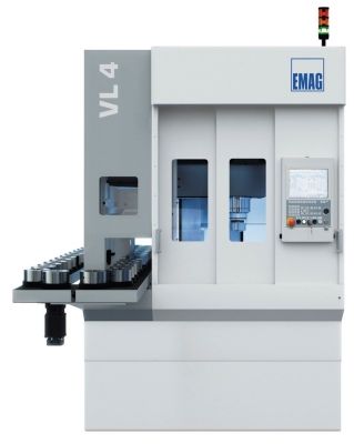

VL 4 Vertical Lathe
The VL 4 is a modular vertical lathe with integrated automation, designed for maximum production at low cost per piece with a small footprint. A pick-up spindle moves in the X- and Z-axes with 12 driven tools on a turret to cut and index parts up to 200mm (7.87") in the shortest time possible. The pass-thru rotary conveyor keeps blanks incoming and machined parts outgoing. Machines can be equipped with a Y-axis for more complex geometries.
