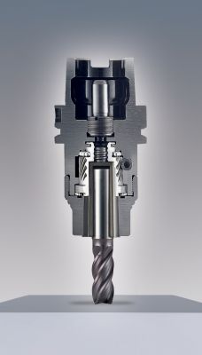

Emuge Corp., in partnership with Albrecht Precision Chucks, has introduced high precision/performance Emuge FPC Mill/Drill Chucks that provide unprecedented rigidity, vibration dampening, concentricity, machining speed and tool life versus conventional chuck technologies for milling and drilling applications. These Emuge FPC Mill/Drill Chucks will be featured at Emuge's booth at IMTS 2016.
Featuring the world's only chuck with a 1:16 worm gear, Emuge FPC Chuck's design delivers three tons of traction force. The unique design and body provide 100 percent holding power for maximum rigidity, and the collet-cone assembly absorbs virtually all vibration for maximum dampening.
Unique features and advantages include an extremely high transferable torque that provides maximum process reliability (transferred torque on a tool shank diameter of 20mm is 400 Nm); increased accuracy with a 3 x D tool length, concentricity is ≤ 3 µm to guarantee long tool life and quality work piece surface finishes; a chuck that is mechanical drive-actuated with a hex wrench, a simple design that enables quick tool change in seconds; a special holder design that reduces vibration, which dramatically improves workpiece surface finishes and provides exceptionally long tool life; and strong clamping force to prevent the possibility of pull-out.
FPC Chucks are designed to be the fastest on the market today. In a speed comparison with four chuck technologies, using a 20 mm end mill in the same material, the Emuge FPC Chuck enabled the feed rate to be increased by 30 percent with no loss in performance.
Emuge FPC Chucks are available in four shank styles (CAT, HSK-A, SK and BT) in 47 different sku's for a wide range of applications. A full range of high precision collets and accessories are also available for the FPC line. Emuge FPC Collets are available in three size ranges (FPC 14, FPC 20 and FPC 25) in over 35 different sku's, from 1/8" to 1 1/4" and in metric from 2 mm - 32 mm.
