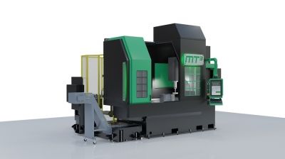

The newest addition to Bourn & Koch’s line-up of American-Made machine tools is the MT3, a multifunctional machine tool platform capable of performing grinding, milling, turning, and drilling/tapping machining operations on a workpiece in one set-up. The machine is primarily designed as a value engineered vertical cylindrical grinder, supplementing Bourn & Koch’s current VBG offering in that arena. The MT3 comes standard with a 42” diameter t-slot worktable and precision grinding spindle with an HSK-50A connection. The machine’s spindles are interchangeable via the innovative HBK-200 clamping system, allowing for the right spindle to be used for the application. The machine will be equipped with custom workholding from Advanced Machine & Engineering to manufacture a hob spindle cartridge from one of Bourn & Koch’s 400H hobbers in one setup. The machine is expandable from a vertical grinder to a “one and done” machine tool system, incorporating various spindles and tools into an added optional cell that are automatically changed via Fanuc R2000 robot and Bourn & Koch’ Alien Claw end of arm tooling, allowing for quick change of most tools and spindles. A spindle rack and disc style tool changer are incorporated to the cell to manage the various tools and spindles for the required operations. The machine is programmed via combination of Bourn & Koch’s grinding HMI and Fanuc Manual Guide-i, employing a Fanuc 0i CNC control for all machine functions. A virtual Y-Axis allows for the machine to perform standard milling functions. The MT3 spindle features a powerful Fanuc Beta-il 160M motor capable of producing 30 kW from 2,000-10,000 rpm, providing ample power and range for a wide variety of grinding, milling, and drilling/tapping applications. This machine platform is modular with future plans for a vertical gear hobbing machine and a five-axis machining center in the works.
