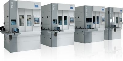

At IMTS 2014, EMAG (Booth N-6846) will feature manufacturing systems for precision metal components with multiple machines from its new modular standard VL and VT product families on display. These modular standard machines offer a systematic approach that is advantageous to establishing a highly efficient manufacturing process, with different operations offered on the same platform, allowing for easy interlinking and eliminating any great capital investment for automation.
The VL vertical pick-up lathe series opens up new opportunities for the machining of a wide range of chucked components. Small gearwheels, planetary gears, sun gears, sliding sleeves, synchronizer rings or flanged components, for example, can be machined with great efficiency. The smallest lathe of the VL product family, the VL 2, machines workpieces with a maximum diameter of four inches and a length up to six inches. Increasing in size, the VL 4, VL 6 and VL 8 offer a number of different turning and milling operations within the framework of a single closed-loop production process. Specially designed for the handling of large components, the largest vertical turning machine of the series, the VL 8, is suitable for commercial vehicle production, handles workpieces up to 16 inches in diameter and 12 inches in length.
Built within the same modular concept is the VT-Series for machining large quantities of shaft components. With four axes, a self-loading turret and integrated automation, the VT 2-4 machines shafts with a max diameter of 2.5 inches and 16 inches in length. Spindle speeds of up to 6,000 rpm achieve extremely short cycle times as the shaft is clamped vertically between workspindle and tailstock and machined from two sides. The vertical alignment of the workpiece ensures process integrity, where the unhindered chip flow prevents the build-up of chip nests in the machining area.
Integrating the technologies of the EMAG Group into these new modular standards, the VLC 200 H will make its North American debut at IMTS 2014. The VLC 200 H hobbing machine integrates EMAG-Koepfer technology into the EMAG vertical platform, including the pick-up design, where the main spindle removes the raw part from the conveyor belt, transfers it to the tailstock flange and removes it from the machining area after the completion of the hobbing cycle. Gears with a maximum diameter of 8 inches and module 4 can be dry-milled at greatly shortened cycle times.
