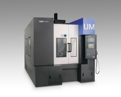

The UM model demonstrated at Hwacheon’s open house featured a 850 mm (33.46") × 500 mm (19.70") work table with 800 kg (1,764 lb) load capacity, strokes of (X, Y, Z) of 750 mm (29.53") × 500 mm (19.70") × 450 mm (17.72"), and rapid positioning of 24 m/min. The 40-taper (BBT & HSK optional) tools are changed in 2.5 seconds.
The bilateral gate structure in Sirius-UM effectively distributes the vibration, weight, and heat throughout the entire frame. Finite element analysis methods help to minimize the frame distortion which may be caused by machining conditions or environment. The distance between the spindle and the body is designed short, so the machine stays stable after a prolonged operation.
The spindle is integrated with the motor to limit vibration, noise, and power loss at high speed rotation. The cooled jets of oil are injected directly onto the spindle bearing for effective cooling, and the motor and the spindle assembly are jacket-cooled to limit the displacement caused by heat. To achieve greater precision, standard Hwacheon software (HSDC) monitors the spindle for possible thermal displacement and makes necessary adjustment in real time.
Sirius-UM provides powerful feed performance using the Z-axis 6-block LM guide. The servo motor is coupled directly to the drive; and while the tensile preload ball screws provide smooth operation, the roller linear guide allows for rapid feed and rigid performance.
