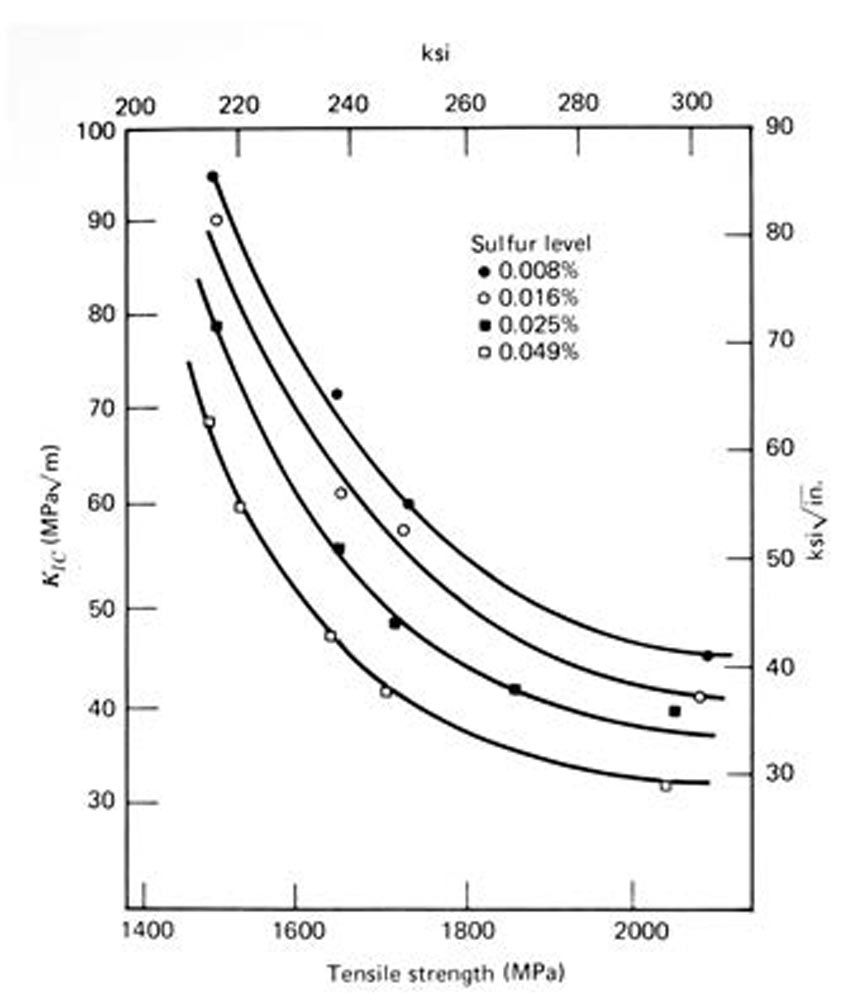

Influence of Tensile Strength on Fracture Toughness
Figure 1 shows that fracture toughness decreases with increasing tensile strength and increasing sulfur content.
Figure 1—Influence of tensile strength and sulfur content on fracture toughness.

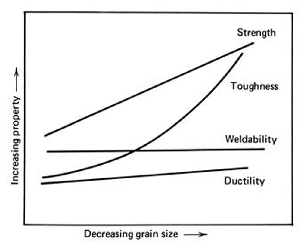

Influence of Grain Size on Tensile Strength and Fracture Toughness
Figure 2 shows that grain refinement represents a unique opportunity where steel may be both strengthened and toughened. This is a particularly attractive strengthening mechanism in view of the generally observed inverse relationship between strength and toughness as shown in Figure 1. Note that weldability and ductility are not adversely affected.
Figure 2—Improvement of tensile strength and toughness with decreasing grain size.

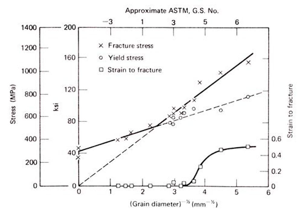

Figure 3 shows that the fracture stress Sf is more sensitive to grain size than the associated yield strength Sy. For grains smaller than ASTM E112 number 3, yielding occurs first and is followed by eventual fracture after a certain amount of plastic flow, the amount increasing with decreasing grain size. Since Sf and Sy are both temperature-sensitive properties, the critical grain size for the ductile-brittle fracture transition varies with temperature. See Figure 4 for more information.
Figure 3—Yield and fracture strength, and fracture strain dependence on grain size in low carbon steel at -192 °C.
