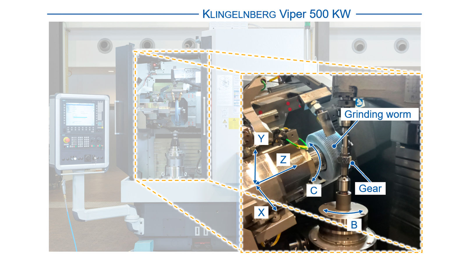

The grinding trials were performed on a Klingelnberg VIPER 500 KW grinding machine. The pinion shaft was centered and clamped between tips, as shown in Figure 3. During the process, the actual value of current in axes B (workpiece rotation), C (grinding worm rotation), X, Y and Z (grinding worm translation) was recorded. Because current and power are directly related if the voltage is constant, and the detectable power signal of the grinding spindle has a lower resolution than the current signal, the spindle current has been measured. The signals were recorded throughout the entire grinding process of each pinion shaft at a sampling rate of fs = 60 Hz. As a tool, a ceramic bonded grinding worm manufactured by Krebs & Riedel was used, with characteristics shown at the bottom left of Figure 3. To prepare the grinding worm for the grinding process, its dressing was performed using a diamond disk dresser.
Figure 3—Experimental setup.

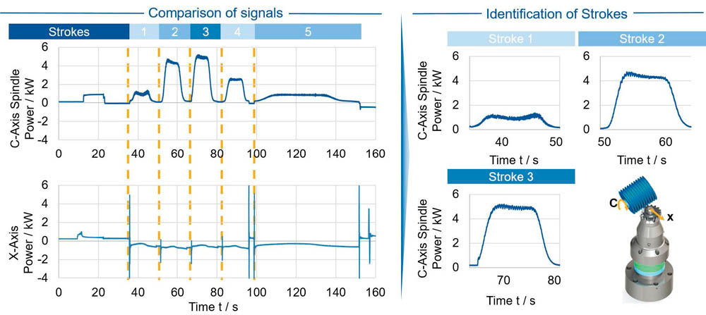

The actual values of current in the entire process were extracted from the machine control. The first step to evaluate these results in terms of energy is to convert the measured current into power, given its relationship to the voltage. The result of this conversion for all the C-axis (tool rotation) and X-axis (tool radial translation) is shown in Figure 5. On the left side of the figure, the signals for the X- and C-axis are compared. On the signal recorded from the X-axis, the presence of peaks at the points where contact starts on each stroke could be identified. Those peaks were then taken as a reference for the distinction of the beginning of each stroke, as shown by the vertical dashed lines. The end of the interval of each stroke, however, was taken as the moment when the value of the beginning of the stroke was reached again (not depicted in the diagram). As a result, each stroke was then distinguishable as shown to the right of Figure 5.
Figure 5—Identification of the stroke intervals in the tool spindle signals.
Typically, signal processing requires applying a filtering process to extract realistic values from the signals. However, the power signals during the trials were acquired at a frequency rate of fs = 60 Hz, significantly lower than common frequency rates in data acquisition (typically 60 kHz to 1 MHz for AE sensors, for example). Therefore, a further reduction of the signal is not necessary.

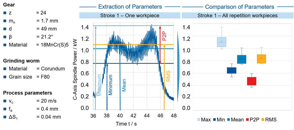

With the signal pre-processed by identifying the regions containing different strokes, it was then possible to characterize the signal by extracting time-domain characteristic values. For this approach, Maximum (Max), Minimum (Min), Median (med), Mean, Peak to Peak (P2P), RMS, Kurtosis (Kurt), K4, Skewness (Skew), Variance (Var) and Krest factor (Krest) were calculated for future comparison to the calculated energy. In the center of Figure 6, a visual representation of a few of the characteristic values for the first stroke of eight repetition trials with the reference parameters of grinding is displayed. In this case, the stroke occurred in the time interval between 36 and 48 seconds from the beginning of the process. Through the plot to the right of Figure 6, it is possible to see the scatter between the calculated values, which indicates the reliability of the current measurements and suggests a viable source of data for further comparison with the generated energy during the process. Therefore, the extracted values can be used as input for the investigation of correlations with the generated energy during the process. Each of those values was then calculated for every stroke, and each of the parameter sets described in the section “Experimental Methodology” to later be used as an input in the approach developed in the section “Development of an Approach for Investigation of the Correlation Between Process Signal Data and Process Energy.”
Figure 6—Approach for evaluation of power signals in the tool spindle axis.

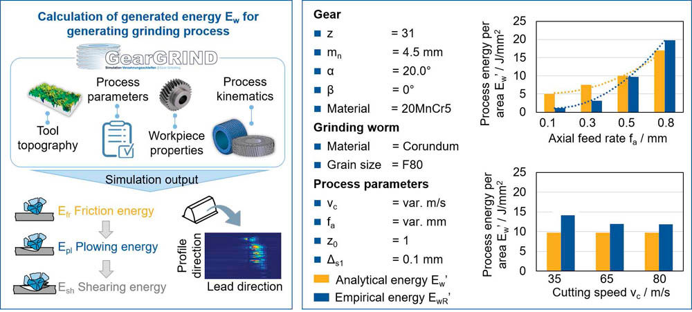

For applying the model for the process investigated in this approach, the first step is to characterize the grinding worm in terms of its tool topography. For this purpose, the topography of the grinding worm is measured using a laser scanning microscope Keyence VKX-1000, following the same approach detailed by Löhrer (Ref. 12). Hence, a fraction of the worm with a large enough size to provide a representative description of the topography—in terms of grain size and distribution—is scanned by the microscope. The resulting measurement is then evaluated using the software MountainsMap, to extract several two-dimensional curves, contained in a plane parallel to the tool surface. To extract curves that may be accurately incorporated into the tool profiles that represent the grinding worm in the simulation, each curve must be parallel to and equidistant from the others.
On the right side of Figure 7, it is possible to see the results which were achieved by Löhrer when applying the model to the generating gear grinding of a 20MnCr5 gear, with the properties and parameters displayed to the right of the figure (Ref. 13). With these parameters, the influence of cutting speed and axial feed on the process energy per area Ew’ (shown in lightest color) was investigated. The results are also compared to those obtained with the empirical model of Reimann (Shown in the darkest color), and for this reason, this analysis is limited to one point on the gear pitch circle, as defined in the analogy trials developed by Reimann (Ref. 19). Within both results, it is possible to see a direct relationship between axial feed fa and energy, although no relevant effect can be seen by the variation of cutting speed vc. According to Löhrer, this behavior likely comes from the fact that the vc is not considered for the construction of the macromovements in the simulation with GearGRIND, and consequently, it is not considered for the calculation of the microinteraction characteristics (Ref. 12). Physically, this can also be explained by the fact that, although cutting forces increase with an increase of the cutting speed, and thus the process power consumption, the contact time also decreases, which may become too short to dissipate the power into the generated energy Ew (Ref. 13). Therefore, in a further analysis of the energy considering process signals, similar behavior can be expected, considering that the power is directly correlated to both the forces and the speeds in the process, through Equation 1 and Equation 2.
Besides the calculation of the generated energy, a particular characteristic of the model developed by Löhrer is the consideration of the different energy shares coming from the distinct chip formation mechanisms (friction, plowing and shearing energies) (Ref. 12). Given the different interactions between the grains and the workpiece during each stage of material removal, each of these shares may represent a different effect on the thermal and mechanical loads of the cutting process. According to Malkin and an analysis performed by Löhrer, nearly all the friction energy Efr is conducted to the workpiece as heat, while the shearing energy Esh presents the lowest conversion into heat to the workpiece of all three energy shares (Refs. 12, 14). Thus, if most of the generated energy Ew corresponds to Esh, the majority of this energy will likely be applied to material removal, and not converted into heat to the workpiece. These interactions suggest the relevance of also considering each different share of generated energy (Efr, Epl, Esh) as a different variable input in the approach for investigation of correlations between the calculated energies and characteristic values extracted from the power signals, as described in the following chapter. Therefore, through the model developed by Löhrer, the process energy in terms of the energy shares must be calculated for each stroke, and each set of process parameters described in the section “Experimental Methodology.” The achieved results will be then considered as input for the approach developed in the next section.

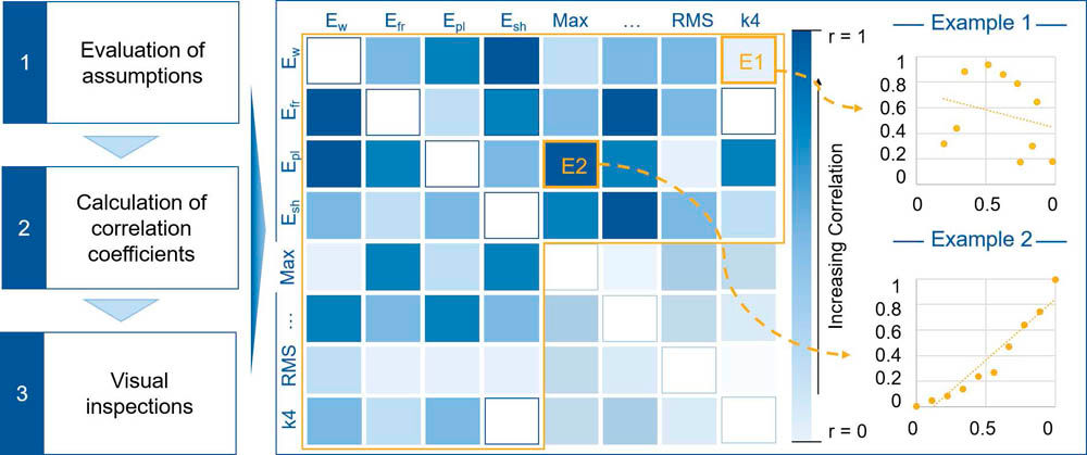

Finally, to achieve an approach that is not only based on coefficients from which it is possible to understand the strength and direction of a relationship, the Mutual Information Mi (Equation 7) is also included in the analysis (Ref. 4). The calculation of this metric allows for the quantification of the amount of information gained about one variable by observing another, by effectively measuring the degree of mutual dependence between them. The calculation of Mutual Information involves the estimation of the probability distributions of each variable, and their joint distribution, therefore, it doesn’t require any assumptions about the data distribution.
(7)
By calculating the correlation coefficients, an evaluation of the relationships between the characteristic values from measured power signals and calculated energy can be made. However, for this evaluation to yield meaningful results, it is initially necessary to ensure that the correct assumptions about the data for the calculated coefficients are fulfilled. Secondly, it is necessary to evaluate whether the results obtained from the calculations are relevant to the overall analysis. To achieve that, the approach shown on the left of Figure 9 is developed.
Figure 9—Approach for investigation of correlations between process energy and spindle power.
In step number 1 of the procedure, a preliminary exploration of the variables is performed, to guarantee that the assumptions made for the calculation of each correlation coefficient are valid. In this step, the linearity, normality and homoscedasticity of the variables will be evaluated to validate the application of each coefficient. With that investigation, it is possible to understand which correlation coefficients can be calculated in step 2 for each relationship between variables. The coefficients will be calculated for each variable combination, yielding a different strength of correlation for each. To evaluate the relevance of the correlations between each variable combination, in step 3, the results will be visually inspected, as exemplified on the center and right sides of Figure 8. Through the heat map shown in the center, it is possible to compare the strength of correlations between each combination, thus allowing us to quickly assess which combinations are strongly (darkest color) or weakly (white) correlated. In this evaluation, the combinations between the total generated energy Ew—as well as the energy shares Efr, Epl, and Esh—and the characteristic values extracted from the power signals, will be observed. Subsequently, through the selection of the most strongly correlated variable combinations, a visualization of the scatter plots of each combination allows for the identification of which kind of relationship (positive or negative, strong or weak, linear or nonlinear) is found between them, if any. Thereby, the application of this method is expected to reveal underlying patterns between power signals and process energy in generating gear grinding, and with that, bring a foundation for identifying the energy generation through real-time measurements of spindle power signals.
