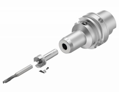

Designed to be clamped in a standard hydraulic chuck, the HiPACS modular system consists of three components that are fast and easy to assemble:
A reducer sleeve with a built-in high-precision pocket seat. In conjunction with a standard hydraulic chuck, this component provides ultra-secure clamping and a runout of no more than 3 μm, significantly increasing tool life and hole quality.
A PCD countersinking insert. This eliminates the need for expensive custom solution step drills, reducing manufacturing costs while meeting the industry’s accuracy requirements.
The two series of solid carbide drills —both diamond-coated and PCD-tipped—covering all material combinations found in a typical aerospace assembly. In addition, the straight shanked tools allow for length adjustments in increments of 10 mm.
