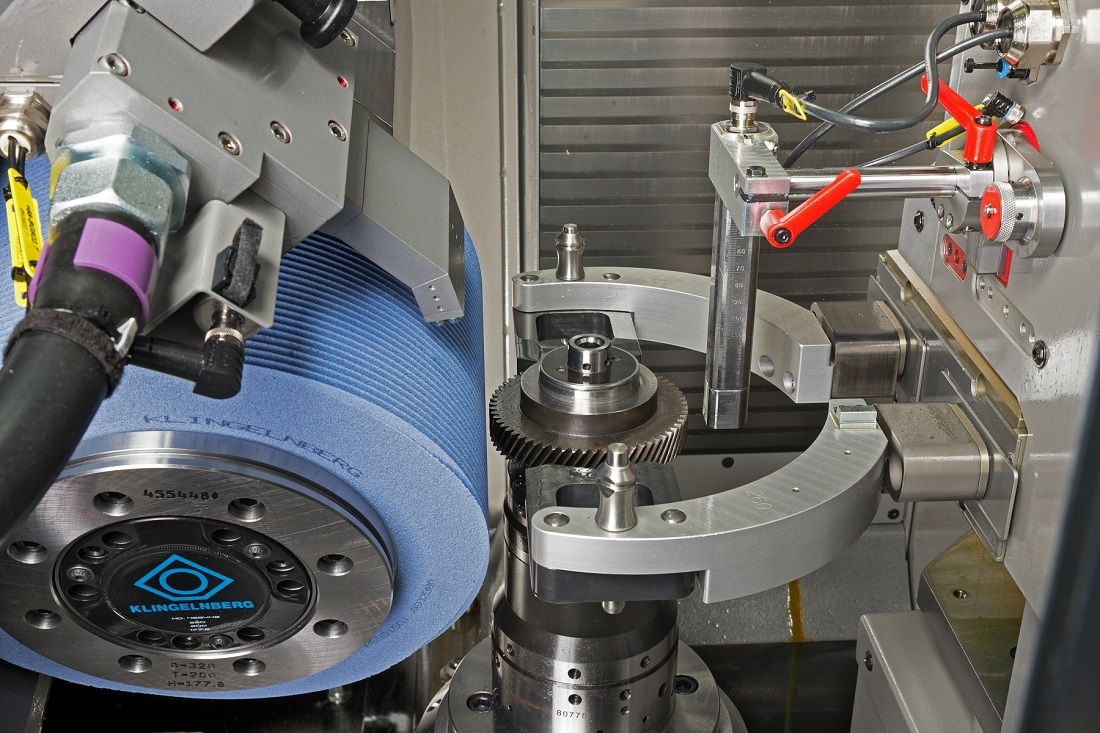

One important parameter in design and manufacturing is twist. Twist causes a premature tooth contact and leads to a high MTE. Twist control for honing is embedded in the shape of the dressing master. Nevertheless, honing does not allow a comprehensive geometry control being robust for non-equidistant stock coming from heat distortions or soft machining. Unequal stock is critical and requires a rather high dressing frequency of the honing tool. In contrast to honing generating grinding offers a perfect control of the gear geometry by effectively eliminating all heat distortions. Only grinding allows an effective control of the flank topography even when the grinding stock is varying. Twist control is state of the art in generating grinding for many years.
Generating grinding leads to gears with a perfect spacing and teeth corresponding to nominal data, as long as the workpiece fixture works accurate, and the grinding machine is capable. The equality of all teeth ensures high quality, and – depending on the design - a low sound pressure level. However, the subjective noise perception might be unpleasant due to the high tonality of the sound experience on the ear.
