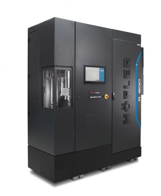

The Höfler Cylindrical Gear Roll Testing Machine R 300 is the latest machine development from the engineering company Klingelnberg in the area of cylindrical gear technology. Designed for all five roll testing methods, this compact machine is the ideal solution for anyone who wants to combine inspection cycles and reduce disassembly costs while benefiting from a user-friendly design.

In terms of axis traversing paths, the Höfler Cylindrical Gear Roll Testing Machine R 300 covers the same component spectrum as the tried-and-tested Höfler Cylindrical Gear Generating Grinding Machine Speed Viper. Gear components up to an outside diameter of 300 mm can be tested, for example. In conjunction with the optional counter support, shafts up to 800 mm in length can be analyzed to determine their running performance and noise behavior. With a minimal footprint of 2 m2, the machine’s compact design also saves costs since it requires very little expensive floor space.

The tried-and-tested design of the human-machine interface (HMI), familiar from the cylindrical gear and bevel gear processing machines, also ensures optimal user-friendliness in the R 300. The HMI is equipped with a 19-inch touchscreen, and important functions, such as “Clamp and release workpiece”, can be initiated via hardware switches. To make the user navigation as easy as possible, the operator is guided via a process-oriented menu structure to only those windows that are necessary for the specific test task at hand. This contributes significantly to the prevention of input errors and shortens the time required to train new employees.
