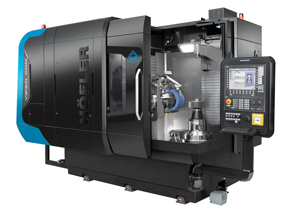

The Klingelnberg Group will be exhibiting at AMB in Stuttgart, the international trade fair for metalworking, from September 15-19, 2026. Klingelnberg will present its latest solutions and innovations at AMB 2026. Among the trade show highlights are the Höfler cylindrical gear grinding machine Viper 500 (pictured above) and the Klingelnberg precision measuring center P 40 with automation. Another focus will be on digital solutions such as Smart Factory and Smart Tracing.
The Höfler cylindrical gear grinding machine Viper 500 is designed for component diameters up to 500 mm and is ideally suited for small to medium batch sizes. Thanks to its modular design, the Viper 500 is available in three different configurations: profile grinding with small grinding wheels for special tasks and multi-wheel technology (K), generating grinding (W) and a combined variant (KW). It can perform both profile grinding and continuous generating grinding on the same machine in the Viper 500 W/KW configuration with minimal setup times.
