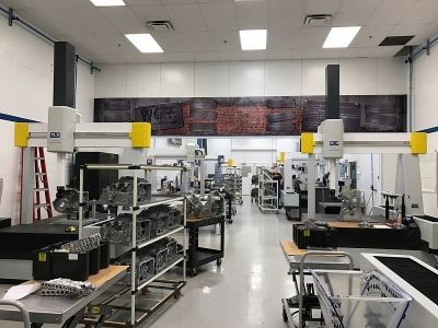

At the U.S. transmission plant of a global automotive manufacturing group, component inspection times have been reduced by half or more following the decision to partner with LK Metrology Inc, which has upgraded all of the CNC coordinate measuring machines (CMMs) on site to use 5-axis scanning technology in addition to touch probing. The Brighton, Michigan-based metrology company is the U.S. subsidiary of British CMM manufacturer, LK Metrology, Ltd. which built 19 of the 26 CMMs in use at the US factory. Two are on the shop floor, while the others are installed in five different quality control (QC) rooms.

About 1,500 steel and aluminium parts per day are inspected, some being the same item but at different stages of manufacture. Overall, 200,000 features are checked daily. The benefit of the present metrology set-up is that each of the five QC rooms houses identical technology and capability, with fixtures and probes freely interchangeable. As a result, any operator can flexibly transfer jobs between CMMs around the site within minutes and it feels like he or she is using the same machine, a level of commonality that delivers highly consistent results. Previously this would not have happened, as the disparate measuring platforms within the facility meant that it would have taken hours or even days to move parts around for checking.
