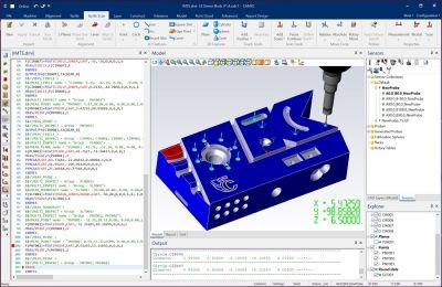

Metrology software has challenges in most application environments—and LK Metrology’s new 8.5 version of their CAMIO CMM software has a range of new features to help meet those challenges.
The CAMIO software has become the “software of choice” for many of the world’s largest manufacturers because it allows the user to focus on accelerating lead times and improving product quality. Regardless of whether inspecting stamped, molded or machined parts, CAMIO drives accurate and efficient inspection programs for geometric features along with full surface analysis with Part-to-CAD comparisons. CAMIO’s interoperability across CMM platforms, sensor technology and manufacturing sites becomes its unique advantage.
The new CAMIO 8.5 software includes the following features/enhancements:
1.Programming Updates.
•Reorganizing of RPS Alignments
•Improvements in angle between tolerances to toggle between acute, obtuse supplementary angles easily
•More precise and pronounced warning messages for users when setting machine/program parameters outside of min/max limits
•The GOTO command now allows the user to specify the number of axes for move
•Updated ACIS CAD engine and support for 3rd party CAD format
2.CAMIO User Interface Improvements
•Window docking was significantly improved
•CAD layers are now displayed in a separate window which provides easier access
•CAD orientation buttons now allow user to keep current zoom level
•Mouse/pointer coordinates now shown in the status bar allows for quick estimation of dimensions
3.Laser and Point Cloud Improvements
•New detection offset parameter for point detection
•Export of point clouds in Geomagic GDP format
4.Ease of Use
•Improvements in the setup of the Machine Launch Utility for offline programming
•Additional options for opening and/or printing CAMIO reports
•Ability to relocate a single stall of rack instead of all the stalls
5.Probe Head Support
•The Renishaw PHS1 servo head and autochange rack are now supported
•The Renishaw SP80 head and autochange rack are now supported
