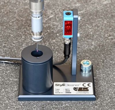

To alleviate the problem, UK-based CMM manufacturer LK Metrology has introduced an automated stylus tip cleaning system, LK StyliCleaner. It takes just 30 seconds to remove debris from a stylus tip, eliminating the tendency to delay cleaning and reducing the risk of taking inaccurate measurements.
During touch probe measurement and particularly when scanning, contaminants such as dust, oil, coolant and oxides build up on the stylus tip. If good metrology is to be maintained, these tiny particles must be removed by frequent cleaning. Automating the process is significantly more efficient than manual cleaning, which typically requires recalibration of each probe position before use, so CMM uptime is maximized.
Being marketed to all CMM users worldwide, the cleaning system is an inexpensive solution and works with all brands of CMM and software. No software integration is needed, just a simple part program for controlling the cycle. For LK CAMIO customers, the StyliCleaner is bundled with free-of-charge part programs for automated stylus tip cleaning.
Controlled by the axis movements of the CMM, the automated cleansing cycle is activated when a dirty stylus is programmed to move in front of the StyliCleaner motion sensor. Once inside the cleaning chamber, the stylus tip is washed for 10 seconds by detergent and dried for 10 seconds using compressed air to remove all contaminants. The part program moves the stylus through six positions to complete the process, leaving it clean and ready for the next inspection.
The compact StyliCleaner, which has a 70 mm (2.8 in) x 100 mm (3.9 in) footprint, is available in two sizes, StyliCleaner8 and StyliCleaner16, designed to decontaminate styli from 0 to 8 mm (0.31 in) and from 6 mm (0.24 in) to 16 mm (0.62 in) in diameter, respectively. The separate control unit may be positioned on the CMM table, or if space is limited it can be attached to the CMM stand using an optional mounting plate.
