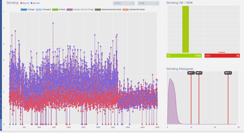

According to the German DIN 8589 standards, the definition of grinding is “a machining process with geometrically undefined cutting edges.” That definition, while true in principle (with respect to the intrinsic structure of a grinding wheel), would be false in practice if it were to suggest that grinding is an imprecise process. For example, continuous generating grinding has proven the most productive process for hard-finishing high-precision cylindrical gears; a process based on a dressable, vitrified bonded, threaded grinding wheel called a grinding worm. A process monitoring system (PMS), such as Reishauer’s Argus, stabilizes a machining process even as complex as continuous generating gear grinding.
By evaluating dressing and grinding intensities through real-time analytics and proven algorithms, each ground gear’s dressing and grinding data are captured and stored in a database where they remain entirely traceable. The PMS renders quantitative data transparent and then uses predictive analytics to make qualitative modifications. This technology helps lead toward zero-defect production, greater precision, and definition of those “undefined cutting edges.” The PMS offers comprehensive data analysis possibilities with stored and tracked process and tooling data and individual workpiece identification via DMC (dot matrix code). Preset evaluation limits in the software govern the process interaction and trigger the automatic removal of workpieces that fall outside the set limits.

One of the essential features of the generating grinding machine is the high output within a short period. For example, for automotive transmissions, grinding cycle times range from eight seconds for small pinions to one minute for ring gears. For this reason, not all ground parts can be measured by coordinate measuring machines (CMMs) due to the measurement times being much higher than the grinding times and the prohibitive costs this would incur. For this reason, the automotive gear industry relies on sample measurements, which represent only a tiny fraction of the total manufacturing lot, generally not higher than five percent.
