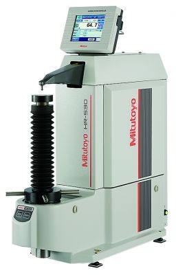

Mitutoyo America HR-530 Rockwell Hardness Testers Features Unique Electronic Control and Inside Ring Hardness Testing
Mitutoyo America Corporation is pleased to announce the release of the latest Rockwell Hardness Testers in its HR-530 Series, including the HR-530 (maximum specimen size height: 250 mm; depth: 150 mm) and the HR-530L (maximum specimen size height: 95 mm; depth 150 mm).
The series features a unique electronic control giving it capabilities for Rockwell, Rockwell Superficial Rockwell testing of plastics (A & B) and Light Force Brinell hardness testing.
The HR-530 features inside ring hardness testing. Test hardness of an inside ring wall without cutting the ring (all models). Minimum diameter is 34 mm, but inside diameters as small as 22 mm can be tested using the optional 5 mm diamond indenter.
It also utilizes a color touch screen displays results of statistical calculations and graphic functions, which can be stored as text data. The touch-panel display can be mounted on top of the tester to save space.
Touch screen functions include:
Direct Hardness Scale Selection: The required hardness scale can be selected with the touch panel. The initial test force and loading force are automatically set in accordance with the selected scale.
