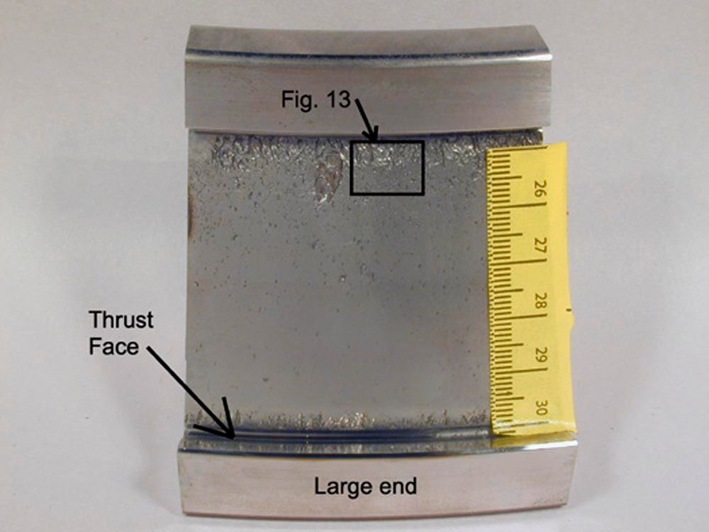

In Figure 3, one can see a section of the IR. The raceway in this section is entirely affected by micropitting, and as a result, secondary macropitting occurs at both edges of the raceway due to geometric stress concentration (GSC). For more details about micropitting and GSC, refer to Ref. 3.
Figure 3—section of the IR with micropitting and macropitting.
Figure 4 shows the section of the IR with severe macropitting.
Figure 4—section of the IR with severe macropitting.
Description of Figure 4
Macropitting is a type of failure that often occurs after micropitting. This is because micropitting can damage the accuracy of some components, such as the OR, IR, and rollers, and increase the internal clearance of the bearing. When the components lose their accuracy and the internal clearance increases, the bearing can become misaligned, leading to GSC. One can identify macropitting by looking for beach marks left by fatigue growth and fretting corrosion in the craters caused by rubbing between the faces of the subsurface macropitting cracks.
It is important to recognize that micropitting is the primary failure mode, with macropitting being a secondary failure mode that occurs due to micropitting.

Figure 13 is an SEM image of macropitting at the edge of the small end of the IR raceway.
Figure 13—SEM image of macropitting at the edge of the small end of the IR raceway.
Description of Figure 13
Macropitting was detected at both edges of the IR raceway. Figure 13 shows macropitting at the small end of the IR raceway. This area is just to the right of the large macropit shown in Figure 3. The macropitting was caused by GSC, which occurred due to the abrupt edge of the micropitting on the IR raceway. Furthermore, the micropitting increased the internal clearance of the bearing, leading to misalignment and further aggravating the GSC.
Macropitting is a secondary failure mode that often occurs at the edges of bearing raceways, following the primary failure mode of micropitting. This occurs because micropitting causes the IR raceway to conform to the rollers and eliminates the crown on the rollers, which creates GSC at the ends of the rollers. For more detailed information on this mechanism, please refer to Ref. 3.
