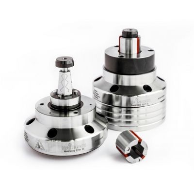

A mandrel with hexagonal pyramid shape instead of a round taper, designed with stringent manufacturing requirements and process reliability in mind. Hainbuch has acted in response to demand from specific areas that has been growing year by year. Users are requesting mandrels that deliver higher performance as well as process reliability. The result is called Maxxos. It exceeds even the specified customer requirements and more than this, offers all the advantages of a hexagonal clamping mechanism. The segmented clamping bushing with hexagon inside shape fits perfectly onto the clamping pyramid and enables maximum cutting performance. The lubrication, combined with its tightness ensures a very constant production flow and as a result, achieves maximum reliability.
Thanks to the hexagonal pyramid clamp, maximum torque transmission can be achieved. Up to 155 percent more transmissible torque and up to 57 percent higher bending stiffness compared to the classic Mando T211 mandrel. This makes it possible to achieve higher process parameters and consequently improve the yield of finished parts. Greater process reliability is facilitated by the spacious layout between the clamping bushing and the clamping pyramid. Even during the clamping process, this design prevents virtually any dirt getting onto the surfaces. This significantly cuts down the frequency of maintenance times for cleaning and lubrication.
Overall, the mandrel has a clamping diameter range of 18 to 100 mm. The clamping areas of each size are designed to overlap. This has the advantage that users can choose from up to three mandrel sizes depending on the clamping diameter. The larger the mandrel is, the greater its stability and rigidity. Smaller mandrels may be able to handle more of the customers smaller workpieces. Users are free to choose the size they want, based on their own judgement and preferences. The aligned, segmented clamping bushings have a minimum concentricity of 0.01 mm and can even be supplied in a high precision version. Learn more at Booth W-3203 during the show.
