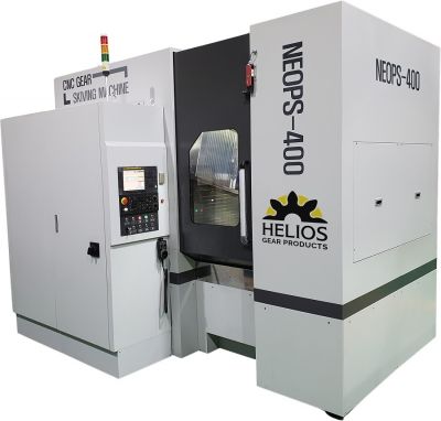

For productive manufacturing of internal gears, Helios will feature the Neo Power Skiving (“NEOPS”) line. This series of machines, which includes the models 100, 200, and 400, produces internal or external gears for parts up to approximately 16.5” outside diameter. Compared to traditional shaping, a NEOPS can produce precision gears in a fraction of the time, making it a go-to choice for manufacturers of internal gears. “Show attendees will really want to stop by and learn about the Neo power skiving machine, which offers this cutting-edge technology at a fraction of the price compared to competitors in the market,” said David Harroun, Helios vice-president.
