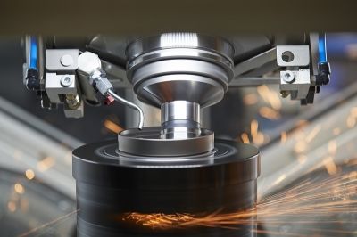

Generating Skiving
Every automatic transmission features several planetary gear sets with internal gearing that could be hard-finished if an adequate process were available. For this reason, Reishauer designed a very stiff generating skiving machine and concurrently developed cutting tools that feature superhard material for their cutting edges. This combination enables the generating skiving process to be economical and successful for the hard-finishing of internal gear components.
