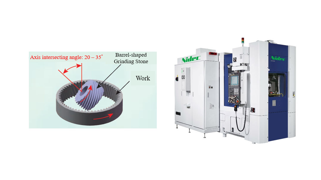

Processing machine: The Company used ZI20A, the grinding machine that it used its unique technology and was launched in 2009 for internal gears for mass production. This machine can process internal gears with high precision to the degree of productivity required for mass production.
Selection of grinding stones for polishing: The Company selected grinding stones, which are consumables, based on its preliminary assessment of their availability, economic efficiency, and suitability for autonomous driving.
Specifying machining conditions: By targeting Ra0.1μm and Rz1.0μm or less (a general surface roughness index for polish machining), the Company derived high-efficiency machining conditions that would maintain the post-polish gear accuracy of ISO levels 3 - 5, while preventing grinding burn.
