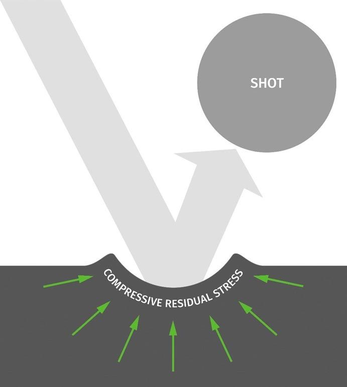

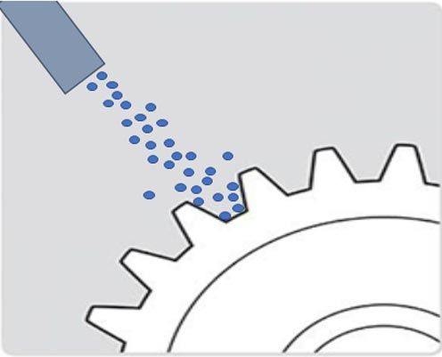

Shot peening is a common process utilized in gear manufacturing to increase the amount of compressive stress and, consequently, increase the fatigue life of the gear. Often applied in the root area, shot peening involves blasting the surface of a component with hard “shot” (Fig. 1). A thin layer of the component is deformed and compressed while the core, or deep sub-surface volume, resists this compression (Fig. 2).
stresstechFig1.jpgFigure 1—Shot peening involves blasting the surface of a component with hard "shot."
stresstechFig2.jpgFigure 2—Shot peening results in a thin layer of compressive residual stress.

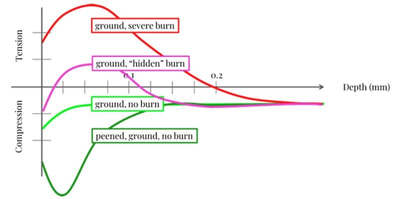

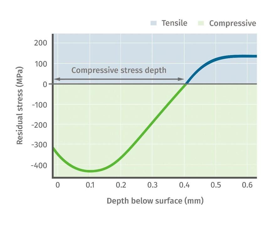

The result of this process is a layer of compressive stresses from the surface through some depth often a few hundred micrometers deep (Fig. 3).
stresstechFig3.jpgFigure 3—The compressive residual stress from shot peening can be a few hundred micrometers deep.

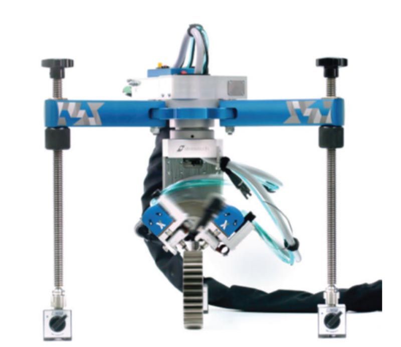

The Stresstech Xstress DR45 system (Fig. 4), utilizing state-of-the-art detector technology, is sensitive enough to make previously slow measurements lightning fast, or previously difficult measurements easy. Utilizing high-sensitivity 2D detectors, the DR45 measures so fast that it doesn’t even need to stop moving to collect diffraction data.
stresstechFig4.jpgFigure 4—The Stresstech Xstress DR45 system.

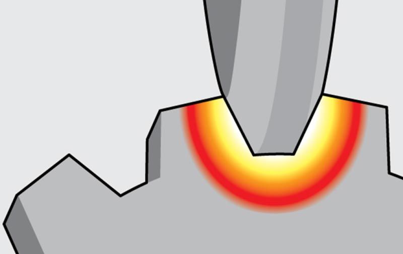

Grinding is a crucial step in gear manufacturing, and it frequently presents manufacturers with a critical question: How fast can I grind without generating a grinding burn? Faster cycle times are always desirable but greater infeed, wheel speed, etc. can result in more energy, or heat, being deposited into the workpiece (Fig. 8).
stresstechFig8.jpgFigure 8—Aggressive feeds and speeds can result in grinding burn.
Grinding burn occurs when the heat generated in the workpiece during grinding is great enough to act as a tempering process or, in the case of even higher temperature, a re-heat treatment of the affected surface. The result of this localized thermal event is a transformation of the microstructure, much the same as what occurs during heat treatment. The affected volume of material is transformed from a desirable microstructure, such as tempered martensite, to an undesirable mix of over-tempered martensite (or softer ferrite, etc.) and untempered martensite. The transformed microstructures have differing densities but, squeezed into the same space previously occupied by the desirable microstructure, then must be compressed and/or pulled apart in order to fit. This compressing or pulling manifests as residual stresses in the material.

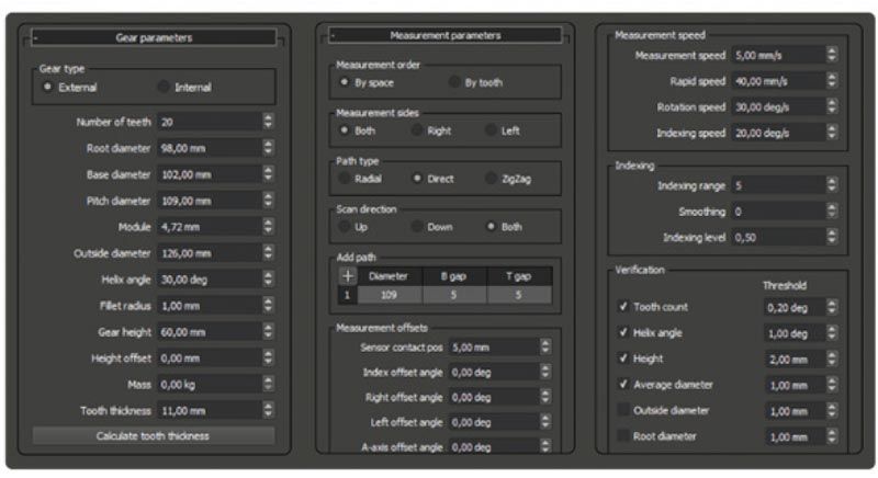

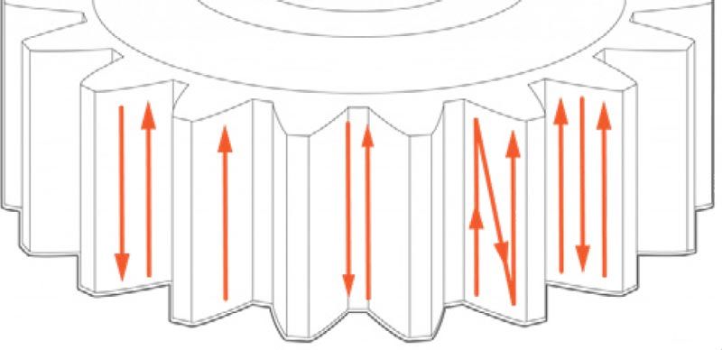

Automated systems are programmed in the same manner as an analytical gear checker with the ability to map the surface of the flank to the level of spatial resolution required for the applicationby utilizing Stresstech’s EasyGear software (Fig. 11). Gear flanks and roots, along with various other surfaces such as faces, ODs, and IDs are all measurable with MBN instruments (Fig. 12).
stresstechFig11.jpgFigure 11—Stresstech EasyGear software for programming of automated gear testing.

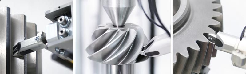

stresstechFig12.jpgFigure—12 MBN instruments can measure gear flanks, roots, faces, ODs and IDs.

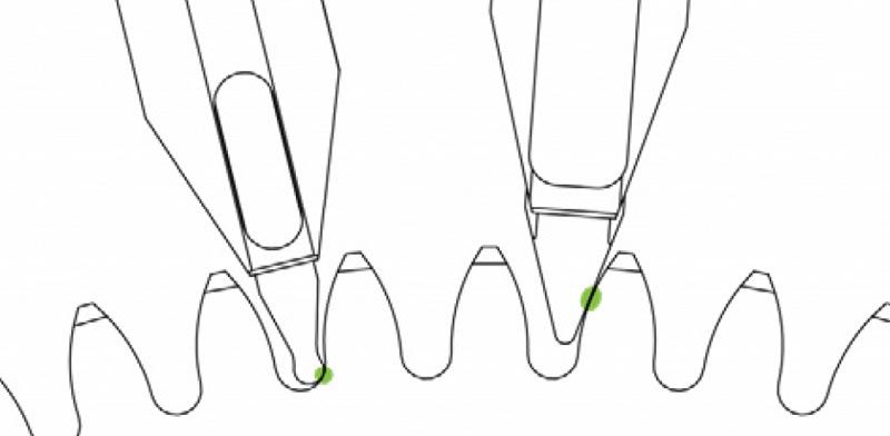

Customized sensors are sometimes required depending on the geometry of the surface to be inspected. For example, gear flanks and gear roots are typically measured with dedicated sensors which facilitate the sensor contacting the area of interest (Fig. 13).
stresstechFig13.jpgFigure 13—Customized sensors can be used, depending on the surface to be measured.
In the case of more complex geometries, such as hypoid gears, custom sensors are utilized, and sensor movement paths are generated along complex curves generated point-by-point (Fig. 14).
