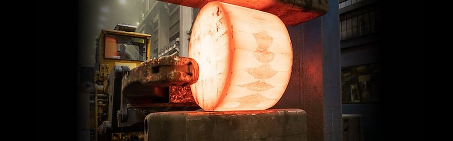

What is Open-Die Forging?
Open-die forging, also known as free forging, involves shaping metal between multiple dies that do not completely enclose the material. The process allows for continuous deformation, producing strong, durable components with refined grain structure. Open-die forging is commonly used for large, customized components that require superior mechanical properties.
