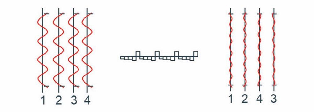

In the practice of gear measuring technology and quality control, gear designers like to modify the recommendations of DIN ISO 1328. In quality control as well, the target values for Cg and Cgk are often compared against concrete values, as are the sigma intervals and the tolerance factors. To define the demands on modern measuring equipment more precisely, it is helpful to take a look at the typical problem sources of gear noise caused by gears (see Figure 1).
Figure 1—The three typical noise sources of a transmission caused by gears (from bottom to top): uniform profile deviations, uniform single pitch deviations, and nonuniform profile deviations distributed periodically over all teeth (here on four different teeth).
Uniform Profile Deviations
Uniform profile deviations originate, for example, from the tool or are remnants of feed marks from the preliminary process. They are equally distributed on all teeth and are reflected in the tooth mesh frequencies as well as their multiples. Often, these amplitudes are in the 0.8 μm to 3 μm range. Theoretically, these defects can be detected by measuring a profile line of a tooth. In practice, three or four profile lines are often measured on different teeth. Thus, these defects can usually be determined with sufficient accuracy.
Uniform Single Pitch Deviations
These defects are responsible for low frequencies (3rd to 8th order), and the amplitudes are in the range of 0.4 μm to 3 μm. They originate, for example, from inaccuracies of the tool or processing machine, or from inadequate mounting of tools and blanks, or they are caused when machines are started up. A pitch measurement requires measuring all teeth on the pitch measuring circle at one or more depths. To correctly determine the amplitudes of the defect, it is necessary to correctly determine the axis position of the component in addition to ensuring that the measuring equipment is accurate.
Nonuniform Profile Deviations
These defects vary from tooth to tooth but occur periodically over the entire periphery. Their amplitudes are in the 0.02 μm to 0.8 μm range and are responsible for what’s referred to as ghost frequencies, or ghost orders, in the evaluation. Causes for this type of deviation include the stability of the tool used in production as well as dynamic effects during production, such as vibrations, etc. In order to reliably detect nonuniform profile deviations and analyze their effects on gear noise, as many teeth as possible must be measured—and ideally all teeth. This task is usually very time-consuming with conventional tactile metrology.

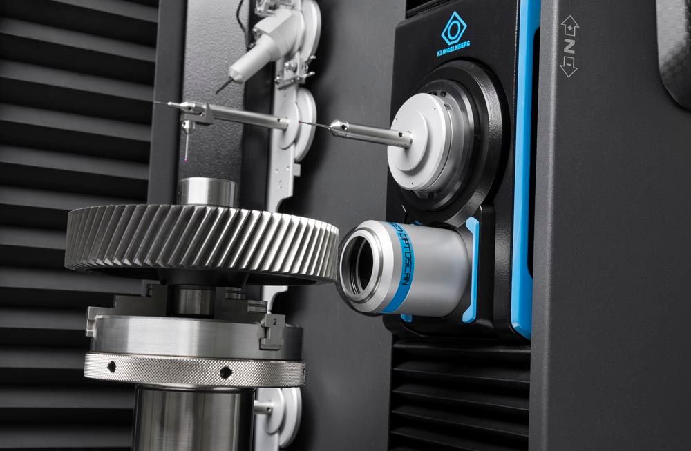

Uniform deviations—both in profile and pitch measurements—can currently be determined quickly and with sufficient process reliability using hybrid precision measuring centers. The profile lines are measured using the tactile method and the pitch by means of optical sensors. Both systems achieve sufficient accuracies even under production conditions. Complete integration of optical metrology as a hybrid measuring concept in the precision measuring center means that the fast, contactless metrology benefits from flexible, tactile measurement of the workpiece axis, temperature compensation, and vibration isolation as an optional feature. Nonuniform profile defects currently require a comparatively high measurement effort. The required measurement precision in the form of a standard deviation of σ

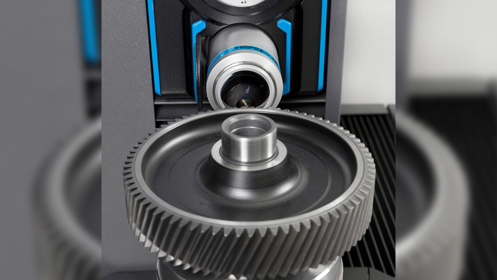

As shown in the example described here, for modern gear measuring tasks, a measuring system benefits from increased speeds—but this must not be at the expense of accuracy. The Klingelnberg optical system was developed and produced largely in-house and optimized for maximum accuracy right from the start. Optical pitch measurement has been achieving consistently reproducible results since the first delivery in 2021 and is thus the first step towards solving current challenges with modern metrology and conventional accuracy (see Figure 2).
Figure 2—Hybrid metrology on a final drive for electromobility, gear quality 4 according to DIN ISO 1328, 82 teeth.
