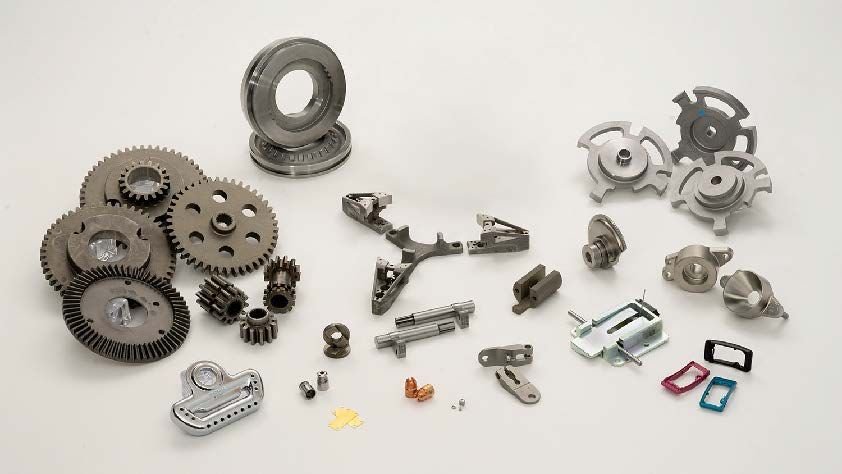

The winners in the 2024 Powder Metallurgy (PM) Design Excellence Awards competition, sponsored by the Metal Powder Industries Federation (MPIF), demonstrate outstanding examples of PM’s diversity and ability to meet critical requirements. From electric vehicles to medical implants, once again, parts fabricators have demonstrated PM’s versatility and unique ability to challenge competing technologies. These award-winning components use PM’s flexibility to push forward new concepts and process controls to demonstrate the inexhaustible range of PM’s capabilities.
Ten Grand Prizes and seventeen Awards of Distinction were given in this year's competition, segmented into 3 categories: Conventional Press and Sinter PM; Metal Injection Molding (MIM); and Metal Additive Manufacturing (AM).

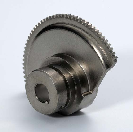

In the Hand Tools/Recreation Category for Conventional PM components, an Award of Distinction has been given to Capstan for a stainless-steel drive gear used in a throttle system with a stack-up of three stainless-steel PM gears. Multi-level tooling was used to create the five separate levels of the part and intricate powder transfer and motions were required to displace material for the “slot” surface due to the thin cross-section. The compaction process achieved about 60% of the final shape of the part and secondary CNC lathe turning and milling operations were used to achieve the bore depths, hub diameter, groove, and tapped hole.
