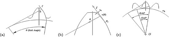

In tooth modification design, tip relief is defined as the thickness v of the material removed along the tooth flank with reference to the nominal involute profile. Profile modification is usually defined versus the roll angle coordinate (Θ), shown in Figure 1 (a, b), and measured in the direction of the inner normal, shown in Figure 1 (c).
Figure 1(a)--Definition of the roll angle Θ. Figure 1(b)--Definitions of: profile modification v = v(Θ) as function of the roll angle, the total thickness at the end of the flank either for pinion veP or gear veG and the start roll angle for either pinion ΘP or gear ΘG. Figure 1(c)--Definistion of start of active profile (SAP) and end of active profile (EAP) angles.
The type of function v = v(Θ) is usually indicated as profile modification topography. Meshing sensitivity to topography is explored throughout this article.

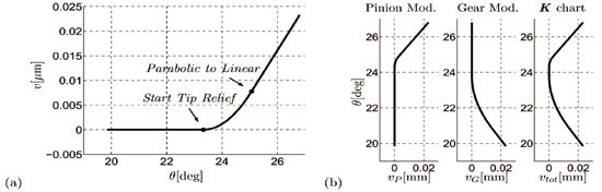

The new topography proposed here is able to exploit both linear and parabolic topography properties since it is a linear relief with a parabolic fillet, as shown in Figure 2. The topography shown here has never been found by the authors in the technical literature.
Figure 2(a)--Tip relief profile modification definition. Figure 2(b)--Example of pinion-gear tip relief modification and K-chart combination.

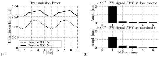

Transmission error produced by the modification pattern of Figure 2 is shown in Figure 3, along with a fast fourier transform analysis of TE. In Figure 3(b), the mean value of the TE signal is eliminated, first frequency component is predominant, and it is remarkable that with higher load, PPTE and first frequency amplitude can be smaller than with lower load.
Figure 3(a)--TE at low torque and nominal torque applied. Figure 3(b)--Fast Fourier Transform (FFT) of the TE signal, both cases.
As discussed, PPTE can be effectively considered as the main parameter of TE roughness (Ref. 8).

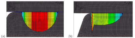

Corner contact boundary. Corner contact is produced when the contact region includes zones of the fillet of the tooth tip (Ref. 17). As a consequence of tooth deflection,the effective contact ratio is greater than that found according to rigid geometry. Hypothesis: The contact pressure rises locally at the tip fillet, as shown in Figure 4.
Figure 4(a)--No corner contact detected. Figure 4(b)--Corner contact detected.
This definition of corner contact can be exploited if an FEM analysis is performed. When the corner contact is detected, the calculated pressure peak was not considered reliable since the maximum is strongly affected by the radius of the fillet, which is a very unpredictable quantity.

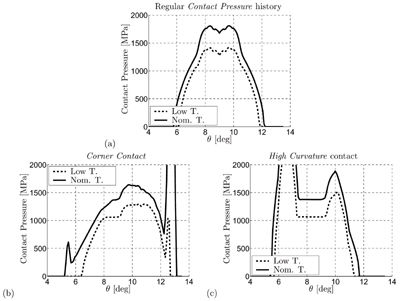

High curvature boundary. There is also the possibility of getting an anomalous contact condition if the tip relief is too high along the tooth profile. In this condition,high curvature occurs and then contact pressure is expected to be much higher than the Hertz model according to the nominal involute curvature.
In Figure 5, three contact pressure histories are shown in which only linear-parabolic profile modification parameters are modified.
Figure 5(a)--Regular contact pressure history configuration. Figure 5(b)--Corner contact configuration. Figure 5(c)--High curvature configuration.
For each case, two load conditions (nominal and low load) are shown in comparison. It is worth noting that corner contact is related to torque versus tip relief, so configuration can show corner contact if the load is high enough. This is obviously detectable only if loaded tooth contact analysis (LTCA) is considered.

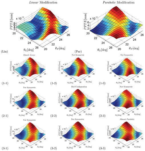

For nominal torque, the effect on PPTE of the migration from linear to parabolic topography is depicted in Figure 6.
Figure 6--Nominal load (Lin) PPTE obtained with linear modification topography. (Par) PPTE obtained with parabolic modification topography. Intermediate configuration meshing conditions shown in (1-2), (1-3), (2-1), (2-3), (3-1) and (3-2).
Furthermore, boundaries were applied. Results are reported only for symmetric configurations in Figure 7.
Figure 7--Nominal load (Lin) linear modification. No boundary can consistently be applied. (Par) parabolic modification, boundaries are wider. Intermediate configurations shown in (1-1), (2-2) and (3-3).
When searching the minimum inside boundary, it is clear that parabolic modification is the one that offers a wider acceptance domain. Therefore, larger areas in which PPTE produces an absolute minimum can be considered. Minimum values for configurations shown in Figure 7 are reported in Table 3, not considering boundaries.
Among minimum values reported in Table 3, only the one referring to parabolic modification is acceptable. Though others are lower, they fall outside the boundary. Taking boundary into account, parabolic modification leads to the best result.

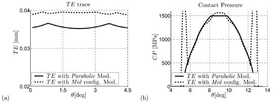

In Figure 8, a transmission error trace is reported both for parabolic optimum (continuous line) and for mid-configuration minimum PPTE configuration. PPTE is lower for mid-configuration, but edge contact is evident. Indeed, this configuration falls outside the acceptance boundary as shown in Figure 7.
Figure 8(a)--Parabolic optimum TE trace. Figure 8(b)--Mid-configuration linear with parabolic fillet optimum TE trace.

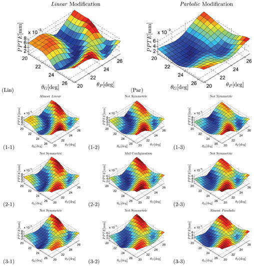

For low torque, the migration from linear to parabolic topography is depicted in Figure 9. For this load level, no boundary related to contact pressure was applied since load is not expected to be dangerous at this level. Even though there are also necessary conditions of anomalous contact (edge contact or high curvature) at lower load, it is possible to assume that they are confined to useless configurations. Minimum values found at the different configurations are reported in Table 4.
Figure 9--Low load: (Lin) PPTE obtained with linear modification topography. (Par) PPTE obtained with parabolic modification topography. Intermediate configuration meshing conditions shown in (1-2), (1-3), (2-1), (2-3), (3-1) and (3-2).

(Lin) 0.87 µm
(1-1) 0.39 µm (2-2) 0.53 µm (3-3) 0.52 µm
(Par) 0.95 µm
It is worth noting that neither linear nor parabolic topography generates minimum PPTE at both loads.
In the configuration proposed here, minimum PPTE output is generated by a linear with parabolic fillet configuration. However, the optimum is dependent on the load. Therefore, the aim of this article is not to propose this result as a "golden" rule, but to show that the parabolic fillet can be an effective parameter for obtaining an optimum solution.

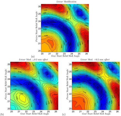

In order to avoid a huge amount of graphical output, sensitivity to center distance offset is considered for linear modification at nominal load. Results are shown in Figure 10.
Figure 10(a)--Linear modification. Figure 10(b)--Linear modification with offset -0.2 mm. Figure 10(c)--Linear modification with offset +0.2 mm.
The entities of offset are around ±0.2 mm. In comparison with modulus, it is clear that perturbations induced by the meshing condition have an influence on the PPTE map.
